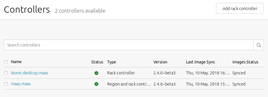

Once registered, this extra rack controller will appear immediately alongside the primary controller in the web UI and begin to sync with it:
You can also list and confirm all registered rack controllers via the CLI. Note that you will need multiple rack controllers to achieve specific high availability configurations.
