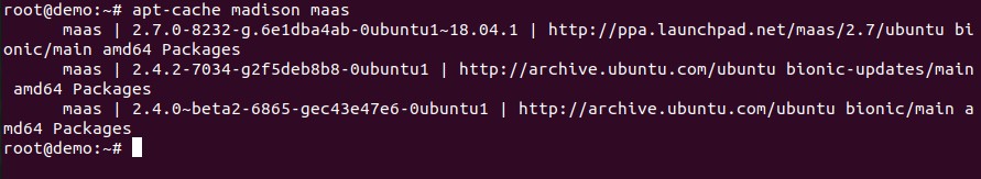

While MAAS is available in the normal Ubuntu archives, the available packages may be lagging non-archive, but still stable, versions. For example, you can check the available versions of MAAS by typing:
apt-cache madison maas
which produces output similar to this:

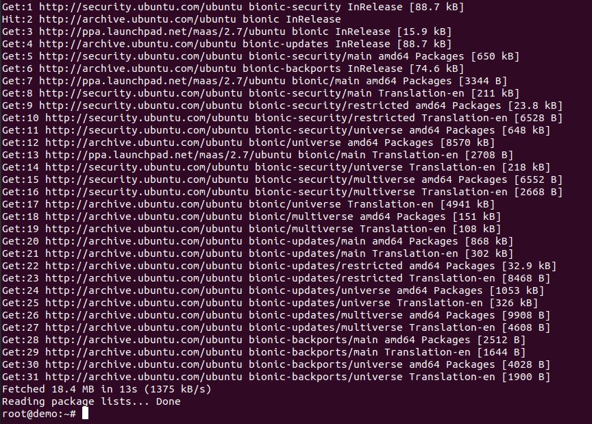

You can install a newer stable version via PPAs listed on the MAAS launchpad, including:
For example, to add the 2.7 PPA, type:
sudo apt-add-repository -yu ppa:maas/2.7
which produces output similar to:
If you check available versions again, you will see that the new repository is now available:
