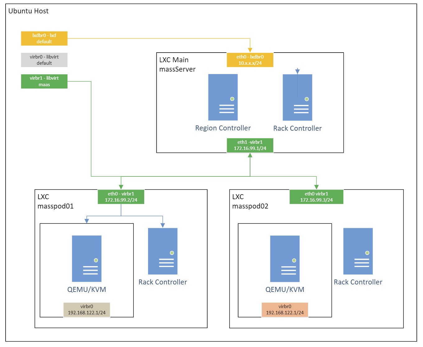

Creating a LXD Container that can itself be a KVM Pod
When testing MAAS 2.5+, it’s helpful to have a MAAS controller running on the same system that is to be used as a KVM pod. (If MAAS can correlate a KVM pod to the host it’s running on, it can be more flexible about how networks are attached.)
The following example shows how to create a container, and use cloud-init
's netplan integration to attach to the existing virbr0
network, and the virbr1
network created above. It also instructs cloud-init to install libvirt and MAAS, making this setup a ready-made KVM pod!
CONTAINER=bionic-maas-pod
CIDR=172.16.99.2/24
lxc init ubuntu:bionic $CONTAINER -s default --no-profiles
lxc network attach virbr0 $CONTAINER eth0 eth0
lxc network attach virbr1 $CONTAINER eth1 eth1

Using this setup passes the /dev/kvm
device through to the containers, and allows a new libvirt
hypervisor to host KVM pods in MAAS (in isolation from the hypervisor already running on the container’s host).
