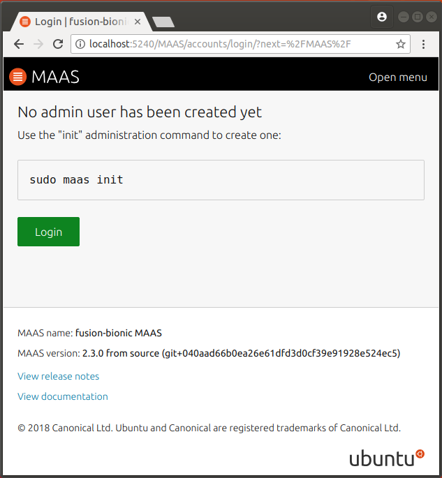

After that, you should be able to browse to http://localhost:5240/MAAS/
and log into the Web UI (replace localhost
with the IP address of the MAAS server if it isn’t running on your local machine, such as in a container or VM).
You won’t have the sudo maas
command available in the development environment, but you can run the equivalent:
bin/maas-region createadmin
You will be prompted for your desired username, password, and your Launchpad username (for importing your SSH keys). If you then return to your browser and enter your username and password, you will be presented with the MAAS “First User Journey” (most options here probably won’t apply, so you can use the “Skip” button in the upper right to bypass it).
