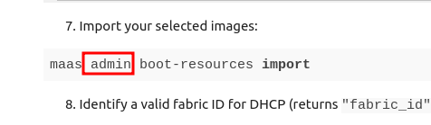

This should be “maas $PROFILE” and not “maas admin”.
