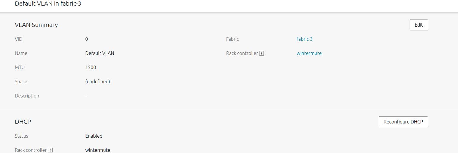

Enable highly-available DHCP services
DHCP HA affects the way MAAS manages node, including enlistment, commissioning and deployment. It enables primary and secondary DHCP instances to serve the same VLAN. This VLAN replicates all lease information is between rack controllers. MAAS-managed DHCP is a requirement for DHCP HA.
If you are enabling DHCP for the first time after adding a second rack controller, please read Enabling DHCP. On the other hand, if you have already enabled DHCP on your initial rack controller, you’ll need to reconfigure DHCP.
Access the appropriate VLAN (via the ‘Subnets’ page) and choose action ‘Reconfigure DHCP’. There, you will see the second rack controller in the ‘Secondary controller’ field. All you should have to do is press the ‘Reconfigure DHCP’ button:
To reconfigure DHCP after adding a new rack controller, use the following sequence of commands:
vid=$(maas maas subnets read | jq -r '.[] | select(.cidr == "10.0.0.0/24") | .vlan.vid')
fabric_name=$(maas maas subnets read | jq -r '.[] | select(.cidr == "10.0.0.0/24") | .vlan.fabric')
query=".[] | select(.name == \"$fabric_name\") | .id"
fabric_id=$(maas maas fabrics read | jq "$query")
maas maas ipranges create type=reserved start_ip=10.0.0.3 end_ip=10.0.0.49
maas maas ipranges create type=dynamic start_ip=10.0.0.50 end_ip=10.0.0.99
maas maas vlan update ${fabric_id} ${vid} primary_rack=$(hostname) dhcp_on=true
Be sure to substitute the sample values for those of your own environment.
