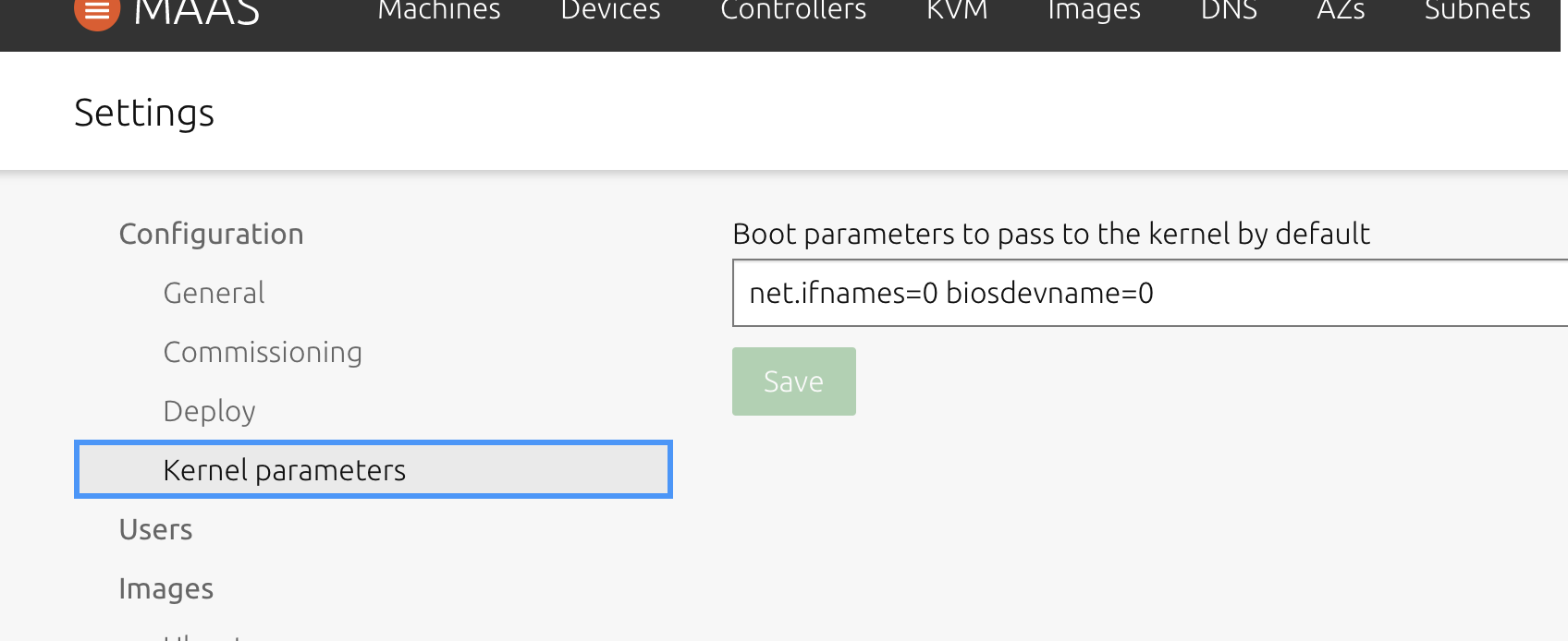

probably worth noting that i have also added net.ifnames=0 biosdevname=0 to kernel parameters in settings otherwise the network doesn’t come up.
