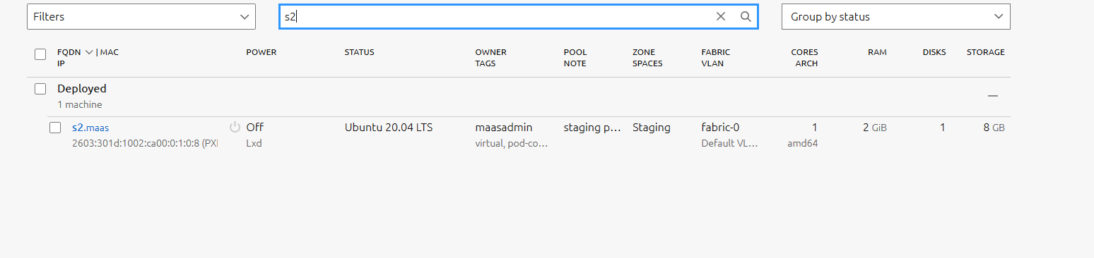

Thanks much for the response @billwear I can definitely provide more context. I’ve “powered off” the vm “s2” (power on and off several times with no issue). Then i run the command lxc config device add s2 gpu gpu. After that, the vm is entirely unresponsive.
When attempting to launch the vm from the host machine, i get the following reported error:
lxc start s2
Error: virtiofsd failed to bind socket within 10s Try `lxc info --show-log s2` for more info
lxc info --show-log s2 returns:
Location: none
Remote: unix://
Architecture: x86_64
Created: 2021/01/13 03:46 UTC
Status: Stopped
Type: virtual-machine
Profiles: default
Error: open /var/snap/lxd/common/lxd/logs/s2/qemu.log: no such file or directory
I’ve reproduced the unresponsive LXD VM on two other machines with NVIDIA cards as well. Again, all is working fine right up to the point where the GPU is added. LXD will not allow me to add a GPU if the VM is running, thus the reason for stopping and powering down. Thanks again for this great system and the responses!
i try to execute the command when powered on but get the following:
lxc config device add s2-gpu gpu gpu
Error: Failed to add device "gpu": Device cannot be added when instance is running
what error message do you get when you try adding a GPU when a VM is running?
i get this error message:
have you seen this page? it may not help, but you never know…
I did try that, but ill give it another whirl. Who knows, maybe I just missed a step.
Oddly enough, lxc containers work just fine. It is the VMs that refuse to work.
i’ll fiddle with it today. maybe i can figure it out. don’t let that stop you from experimenting. :slight_smile:
i tried it. adding a gpu to a vm and starting the vm crashes my laptop catastrophically, whether i’m starting it with lxd start <name> or by turning it on with MAAS. i’ll file a bug and post the link to the bug here.
Thanks much! Always lovely to know that the issue isnt isolate to just me :slight_smile:
so it turns out it’s not a bug, actually; we were asking LXD to do something the wrong way. still trying the get the correct process from the designer, but advice so far goes like this:
"For containers, GPUs are shared by just exposing the GPU device nodes in a container. For VMs, GPU need to be passed through, that is, detached from the host system and attached to the VM over PCIe.
the config you used tells LXD to detach all GPUs from your system and attach them all to the VM, which it did.
