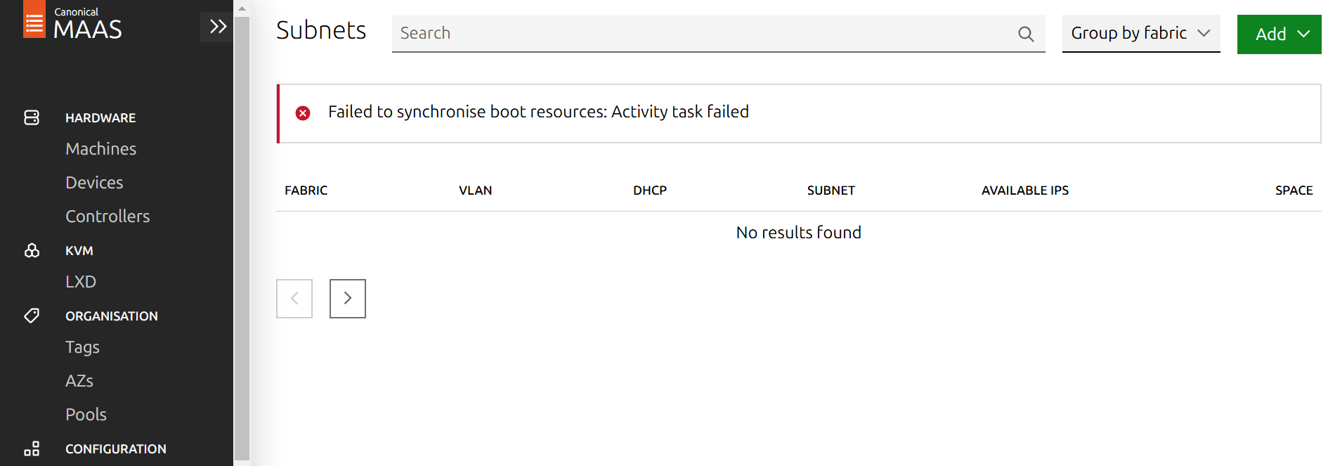

VM configured with DNS and accessed by FQDN where canonical-maas not able to configure subnets
Could you elaborate more what do you mean?
If vm configured with fqdn, fabric and subnets are not created after configuring canonical-maas in that vm.
Can i get any solution?
Could you explain step by step in details what you would like to have?
I have created vm with FQDN.
cat /etc/resolve.conf
search ucpa-png.com
nameserver 172.25.20.211
It’s unable to configure
“Failed to synchronise boot resources: Activity failed”
Also no subnet is configured.

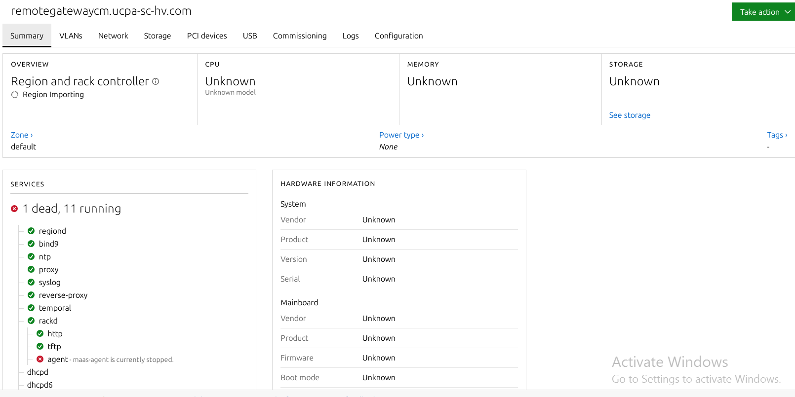

I have executed this command,
root@remotegatewaycm:~# maas status
Service Startup Current Since
agent disabled inactive -
apiserver enabled active yesterday at 18:46 UTC
bind9 disabled active yesterday at 18:47 UTC
dhcpd disabled inactive -
dhcpd6 disabled inactive -
http disabled active yesterday at 18:46 UTC
ntp disabled active yesterday at 18:46 UTC
proxy disabled active today at 06:33 UTC
rackd enabled active yesterday at 18:46 UTC
regiond enabled active yesterday at 18:46 UTC
syslog disabled active yesterday at 18:46 UTC
temporal disabled active yesterday at 18:46 UTC
temporal-worker disabled active yesterday at 18:46 UTC

your broadcast address 172.25.92.255 is outside 172.25.20.211/24
it is 25.92, earlier i put wrong ip mistakenly. inet 172.25.92.211/24 brd 172.25.92.255
any solution for this issue?

In the logs I am getting start maas-agent service failed with exit code 1.
What do you mean that the VM is configured with a FQDN instead of an IP?
I have installed canonical-maas in a VM where FQDN is configured. Therefore, I observed that maas-agent is stopped and it’s not configured the subnet as well.
