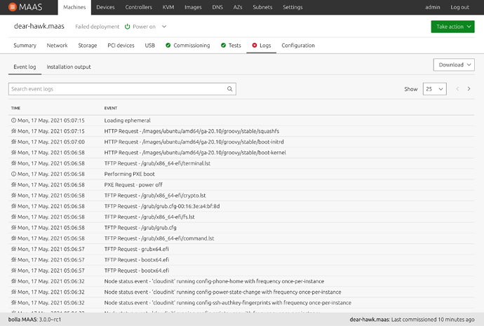

Consolidation of logs and events
The logs and events tabs have combined and now live under “Logs”. In addition to a number of small improvements, navigating and displaying events has been made easier.
Downloading logs
A helpful new feature is the ability to download the machine and installation output, and if a machine has failed deployment you can now download a full tar of the curtain logs.
