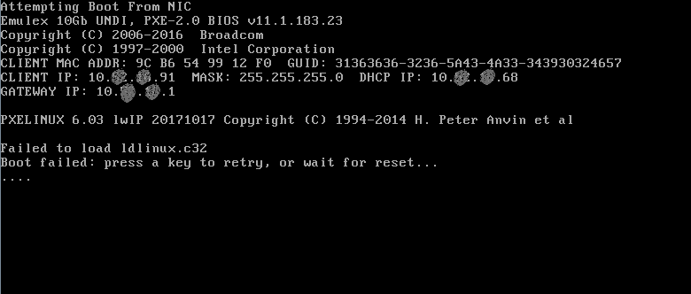

Later I added the maas ppa to update maas to 2.5.0, after that pxe booting does not work anymore.
After the Boot failed message nothing happens anymore.

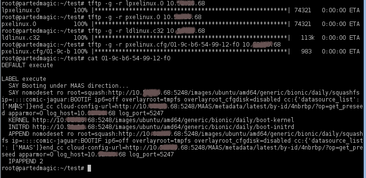

I booted a live cd on the server and connected via tftp to the rackcontroller.
Looks fine so far (i think):

The machine used pxelinux.0 but the result was the same as in the image in my last post. After that I reverted the dhcpd.conf back to the original state.

The server just downloads lpxelinux.0 and nothing happens anymore.
