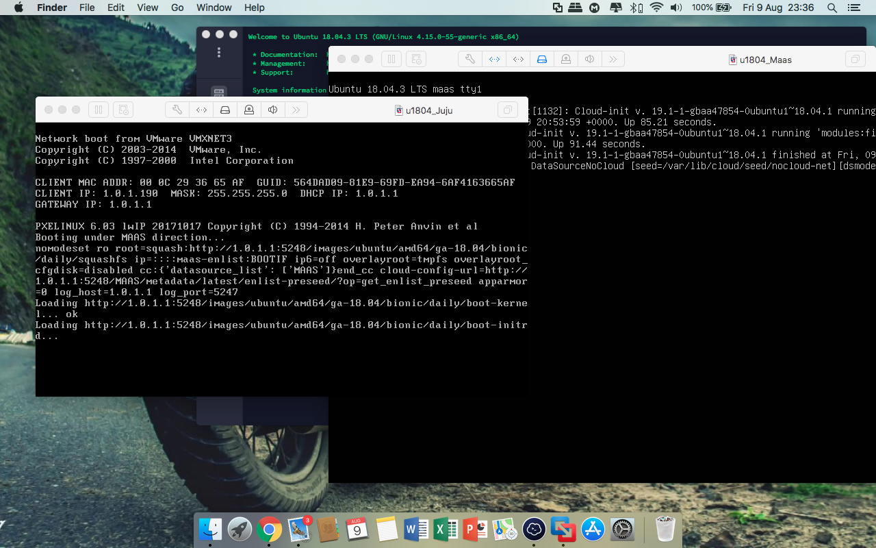

I’ve made the same thing… reverting back to 2.4.2 with the 2.5 and 2.6 the PXE boot on vmware fusion not works.
