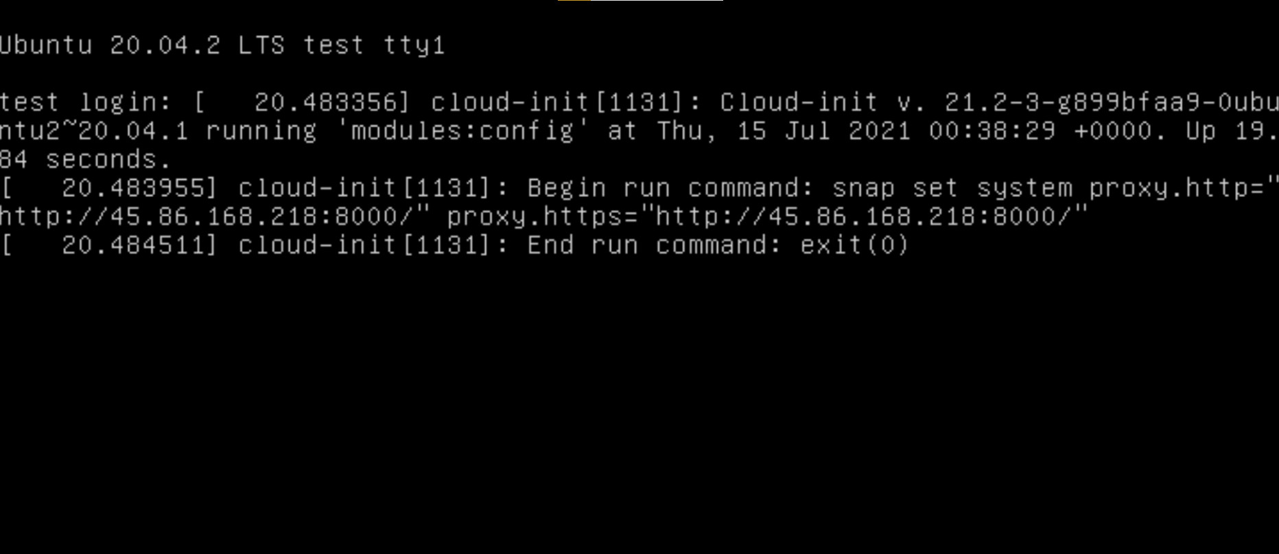

I’ve already got the power set to manual. I’ve span up a VM to simulate my test physical server, so I don’t need to keep getting a technician to start the server as I debug.
So MAAS has finished commissioning the server, and it has the status “Ready”. Now, every time the server (test VM) boots, it loads from PXE, loads Ubuntu, then shuts down as soon as it reaches the login screen. The power type is still set to manual, so the shut down comes from the cloud-init config/some script that MAAS provides.
That’s what I’d like to know how to modify so it does not shut down—checking the checkbox to prevent shutdown before commissioning works just one time but not for future boots.

EDIT: I have found out that MAAS shuts down the server by providing poweroff to the cloud-init module “power-state” that the ephemeral loads. I need to edit this cloud-init config the ephemeral gets to remove that and my problem is sorted. How can I do this?
