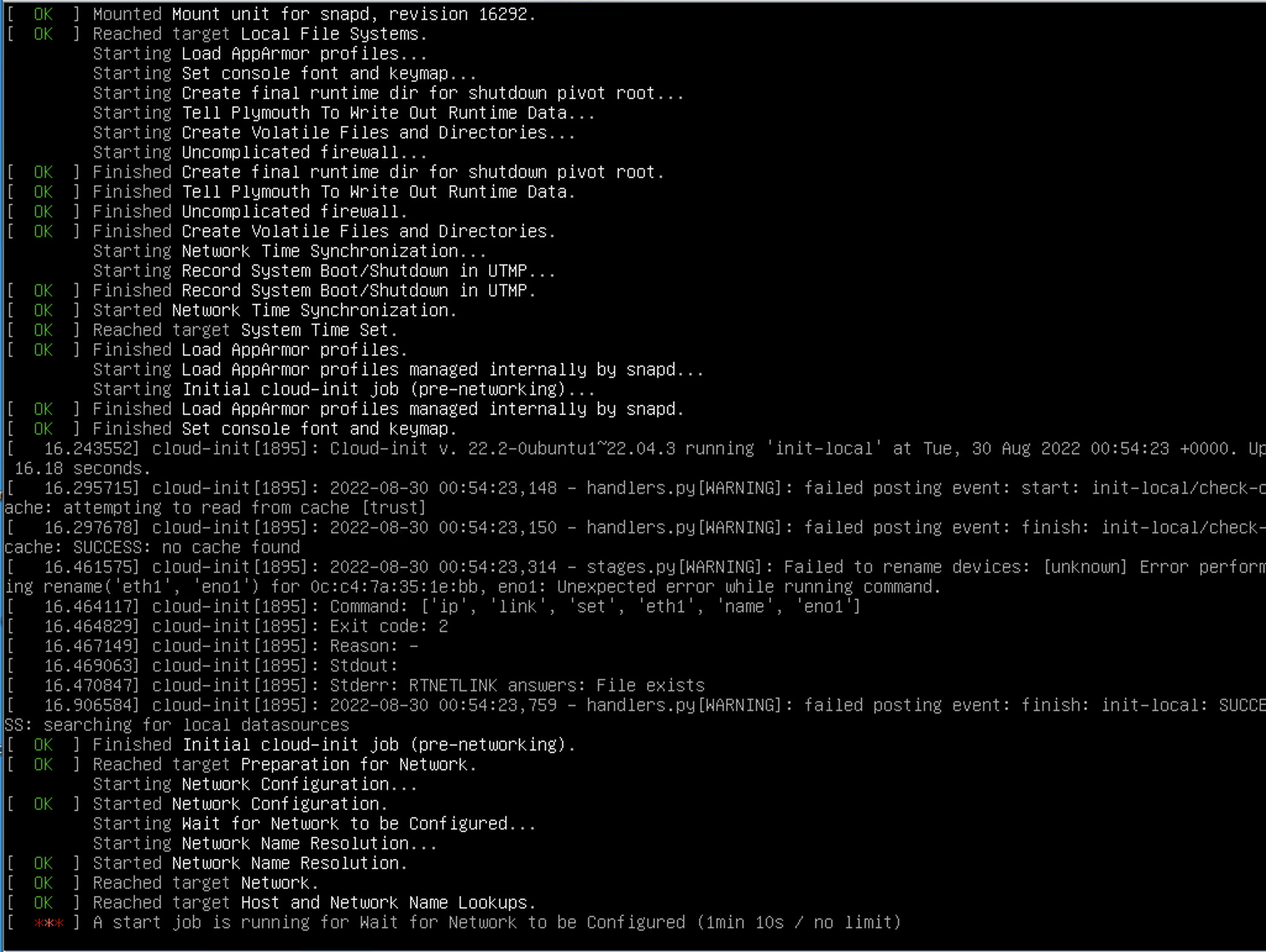

As a potential culprit, I see an error about renaming the NIC in the boot log, and the server hangs for quite awhile on “Wait for Network to be Configured”:
FWIW, I can see from the switch that the server is bringing up and down its network link a couple times during this process. Following that error, the server doesn’t get an IP address and therefore can’t reach MAAS:

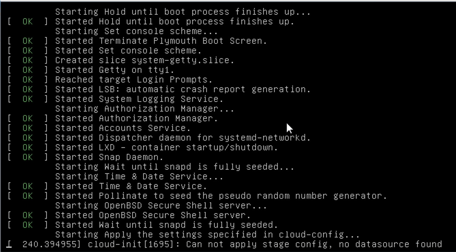

This is still happening and with greater frequency than (I though) it was before. Some machines I can’t boot at all any more, and it’s not limited to the final post-deploy reboot. One machine will not complete the initial pre-commissioning (inventory?) PXE boot at all.
I’ve tried in various versions of Ubuntu, and 18.04 gives a maybe more useful error message than the others (I can’t catch it all due to scrolling in the console, but here are the two frames I was able to catch by taking a screen recording of the IPMI console):
Does anyone know what might be causing this? Shortly before this error, it retrieved the root image just fine, so I am not sure why it could not reach the cloud-init data source at this point…

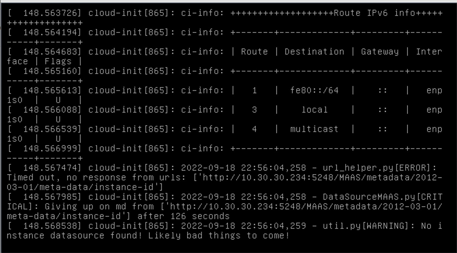

I actually do see the same error in this screen recording (20.04) as I saw in 18.04 (perhaps I didn’t wait long enough the first time).
Another clue: The “wait for network to be configured” seems like it might be a problem, but not the main one. On another run, I can see the server is trying to reach MAAS at the server’s IP! At least, 10.30.30.234 is not an IP address of any of my controllers.
I’ve tried looking through the code to see where this bogus URL might be coming from, but I’m running out of ideas. It looks strikingly similar to this Fedora / cloud-init bug from 2018: https://bugzilla.redhat.com/show_bug.cgi?id=1558641
