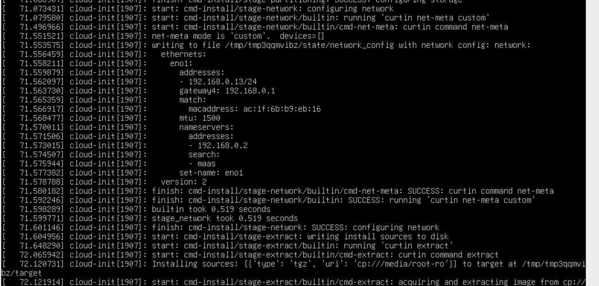

I have IPMI access and did a screen recording.
But unfortunately, I don’t know the default password set by MAAS, so I couldn’t sign in for debugging.
The video seems to be cut. Do you ever get to the console?
Yes – attached is the part 2 of the recording
