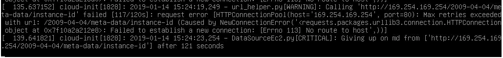

When it reboots at the end I can see a lot of those messages via console :
I don’t know if it means something because later I can see this :
Thank you !
Ludwig
From what I understand it would mean that DHCP is out of IP.
I did arrive at the end of my pool today but it started to take old adresses no longer used and my server has an IP attributed, I can see it in GUI and ifconfig.
Moreover I have no clue if it is related with my “Deploying” status.
I’m still stuck here and I’m not able to deploy servers anymore, it is not a DHCP problem, it seems my server are not able to connect to curtin datasource on the next reboot after install.

Then it reboots and it displays error messages of my last comment, without being able to connect to cloud-init datasource.

I figured out what were wrong with my Ubuntu 18 deployment.
In my preseed I was running this late command :
[“curtin”, “in-target”, “–”, “sh”, “-c”, “sudo apt-get -y install vlan ifenslave”]
I need these packages on Ubuntu 16 to make my network working and I reused this preseed file to run 18.04 deployment.
However installing ifenslave package in late commands simply ruins the Netplan config built with the deployment…
My node was not able to communicate with MaaS at the real end of deployment and so it kept “Deploying” status and then it failed.
