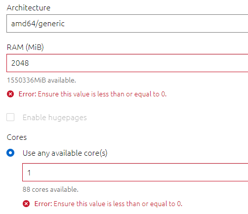

Trying to create VM in an LXD host. Even if there are a lot of memory and cores, it will not accept it.
Any ideas what could be wrong?

2022-02-02 17:43:09 maasserver.websockets.protocol: [critical] Error on request (108) pod.compose: {“cores”: [“Ensure this value is less than or equal to 0.”], “memory”: [“Ensure this value is less than or equal to 0.”]}

raise HandlerValidationError(form.errors)
maasserver.websockets.base.HandlerValidationError: {‘cores’: [‘Ensure this value is less than or equal to 0.’], ‘memory’: [‘Ensure this value is less than or equal to 0.’]}

"memory_over_commit_ratio": 1.3,
"cpu_over_commit_ratio": 4.0,
"version": "6.0.0",
"available": {
"cores": -1,
"memory": -2048,
"local_storage": 236466909184
"total": {
"cores": 0,
"memory": 0,
"local_storage": 244466909184
"used": {
"cores": 1,
"memory": 2048,
"local_storage": 8000000000
"type": "virsh",
The ratios there are the same as the ones I set in the UI. However available and total do NOT match, obviously the system has more than 0 cores and memory
Really those numbers should be 20 and 160GiB respectively, which is how they display in the UI. I do have one VM deployed with 1C/2GiB, so used is correct. And it looks like available is just substracting used from total.
Storage is correct in all cases.
E: and I just realized I can’t create any more VMs than the one that’s already deployed, presumably because available is negative

$ maas ben vm-host compose 9 hostname=juju-controller cores=2 memory=4096 storage='bootvol:40(default)' interfaces='eth0:space=admin-space;eth1:space=data-space'
{"cores": ["Ensure this value is less than or equal to 0."], "memory": ["Ensure this value is less than or equal to 0."]}

@bjornrun, can you show me the whole screen where you’re getting this error?
I did use LXD from the command line to initialize it on the host.

$ maas ben vm-host compose 9 hostname=juju-controller cores=2 memory=4096 storage='bootvol:40(default)' interfaces='eth0:space=admin-space;eth1:space=data-space' {"cores": ["Ensure this value is less than or equal to 0."], "memory": ["Ensure this value is less than or equal to 0."]}
If it was a networking issue, I would expect maas to let me create the vm but it would fail during commissioning.
