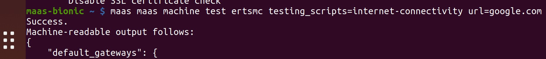

In addition, MAAS can comprehensively test Internet connectivity testing. You can give a list of URLs or IP addresses to check:
In the ephemeral environment, standard DHCP is still applied, but when network testing runs, MAAS can apply your specific configuration for the duration of the test. While all URLs / IPs are tested with all interfaces, MAAS can test each of your interfaces individually, including breaking apart bonded NICS and testing each side of your redundant interfaces. You can also run different tests on each pass, e.g., a different set of URLs, although each run would be a different testing cycle.
To test individual interfaces, for example, you could issue the following command:
Note that in this command, we are testing internet connectivity to the single interface “br0.”
