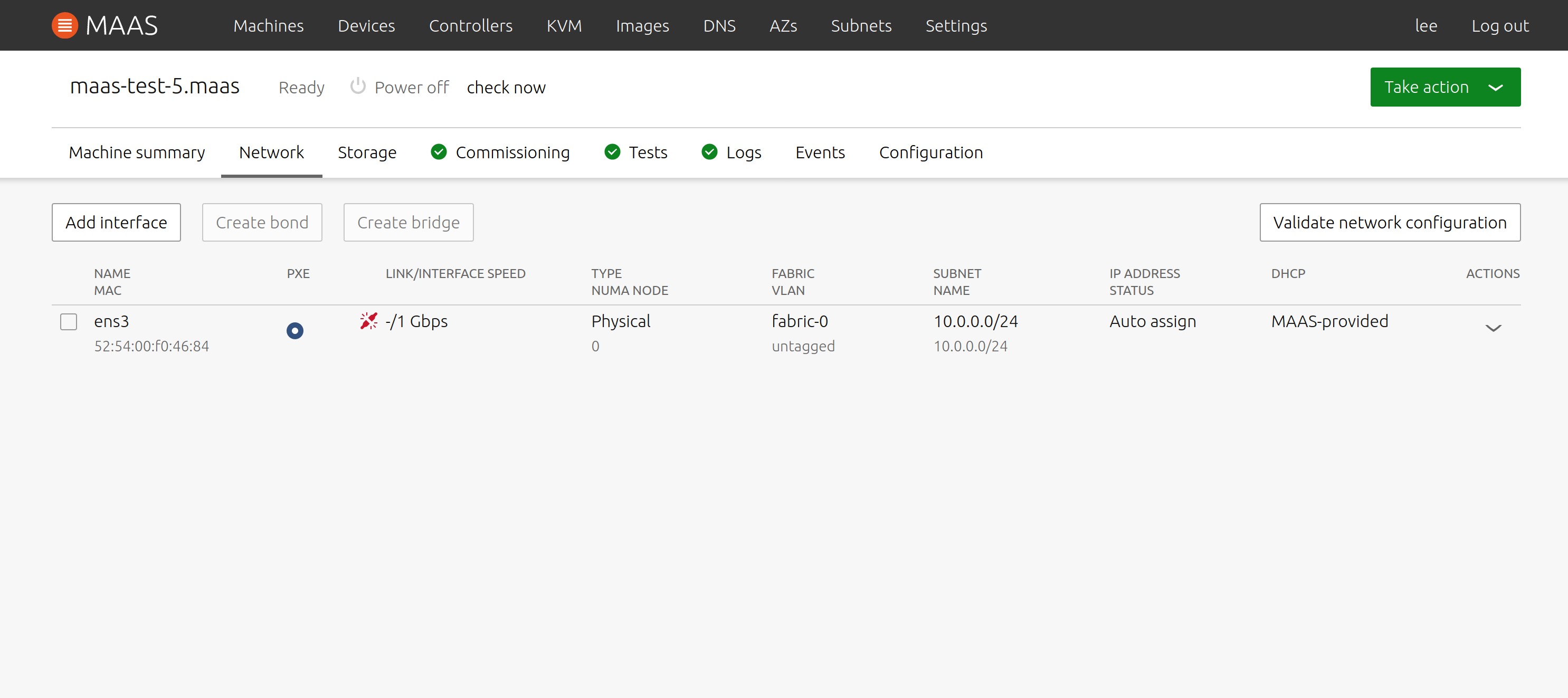

Network link testing
MAAS can check whether links are connected or disconnected, so that you can detect unplugged cables. If you are not running MAAS 2.7, you must first upgrade and then recommission your machines to find disconnected links. MAAS not only reports unplugged cables, but also gives a warning when trying to configure a disconnected interface. In addition, administrators can change the cable connection status after manually resolving the issue.
When MAAS detects a broken network link, users will see a screen similar to this one:
If you’re already using a version of MAAS less than 2.7, you will want to upgrade and recommission your existing machines to check link status. Note that you will also receive a warning from MAAS when trying to configure a disconnected interface.
Once you have manually repaired the broken connection, an administrator can change cable connection status:
