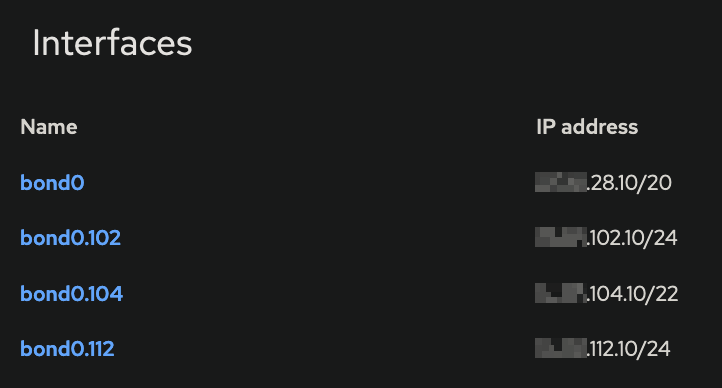

From my understanding, network discovery happens mainly at layer 2 so your MAAS box would need to be setup on each vlan in your datacenter. This will also simplify your DHCP setup since you wonā€™t have to mess with DHCP relays or trying to route DHCP packets. In our setup, I made the interface on the switch that our maas box is connected to a trunk port so it has access to all vlans. (This could be restricted to only the necessary vlans if you want.) Then, I added the vlans to the interface of my MAAS box.

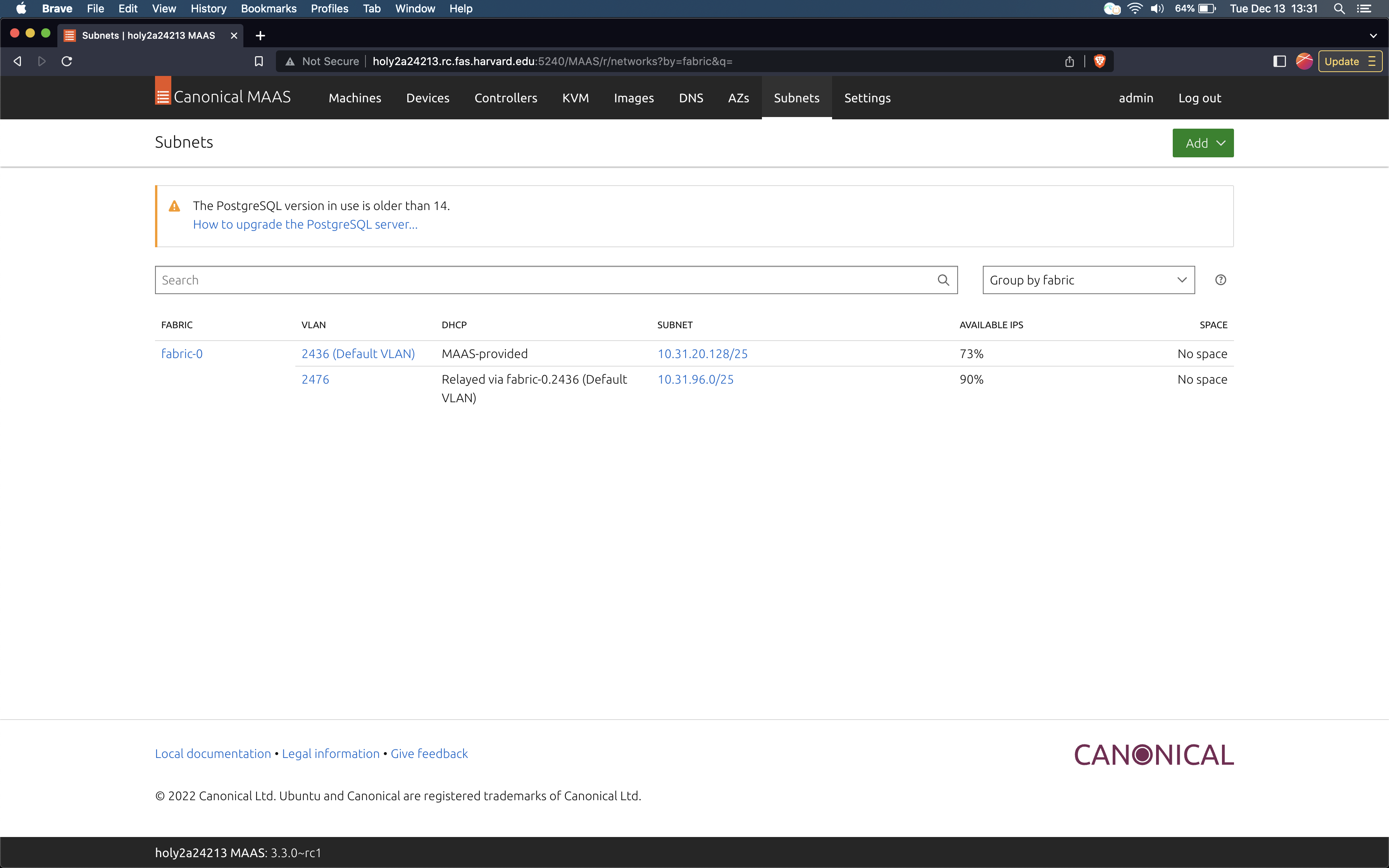

@dcaunt42, can you post a screenshot of your ā€˜Subnetsā€™ tab in MAAS?
@billwear Here is the ā€˜Subnetsā€™ tab. VLAN 2436 is where the MAAS server lives, and the nodes that it is currently deploying to are on VLAN 2476. They have their DHCP requests relayed via a helper to the MAAS server.
and this is working, albeit not the configuration you want?
Correct - if I manually enter the hardware information for a test node on 2476 into MAAS, I am able to commission it and deploy to it. I am also able to PXE boot a node on 2476 and it will get a DHCP address from MAAS so that MAAS can learn about it that way. The only part so far that is not working yet is the discovery (either active or passive). But also, you are correct that this is not the configuration we want long-term. This is our proof-of-concept setup for us to learn about MAAS and see if it would suit our future needs.
