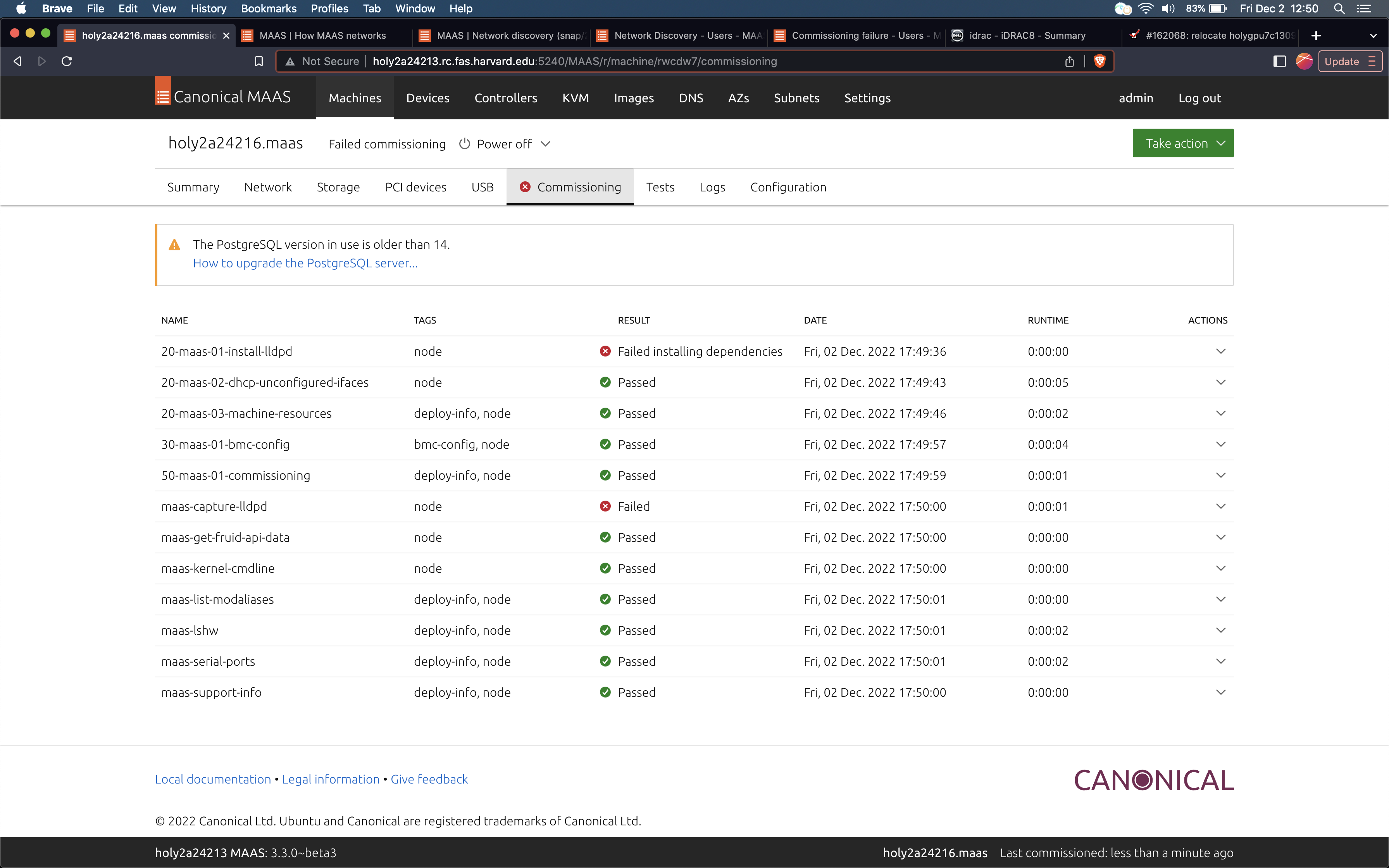

The one time I tried adding the machine first in MAAS (using “Add Hardware”), I got the output shown in the screenshot that I’m attaching. I’m not sure that’s the exact same problem that’s happening when I PXE boot them without inputting IPMI information first, but the pastebin output that I linked from the failed commission does contain an error about “Failed installing package(s) for 20-maas-01-install-lldpd” so maybe it is the same problem.
For anyone else who may be experiencing this problem, we were finally able to solve it. The ephemeral image that MaaS 3.3 uses by default is Ubuntu 20.04. That image has this problem during the commissioning phase (specifically, during 20-maas-01-install-lldpd):
Err:2 http://archive.ubuntu.com/ubuntu focal-updates/main amd64 libmysqlclient21 amd64 8.0.31-0ubuntu0.20.04.2
404 Not Found [IP: 91.189.91.39 80]
It must have an old mirror baked into it. Downloading and using 22.04 as the ephemeral image doesn’t have this issue and allowed us to commission our nodes without the above errors.
