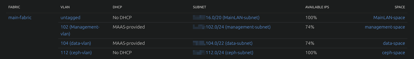

The one time I tried adding the machine first in MAAS (using “Add Hardware”), I got the output shown in the screenshot that I’m attaching. I’m not sure that’s the exact same problem that’s happening when I PXE boot them without inputting IPMI information first, but the pastebin output that I linked from the failed commission does contain an error about “Failed installing package(s) for 20-maas-01-install-lldpd” so maybe it is the same problem.
