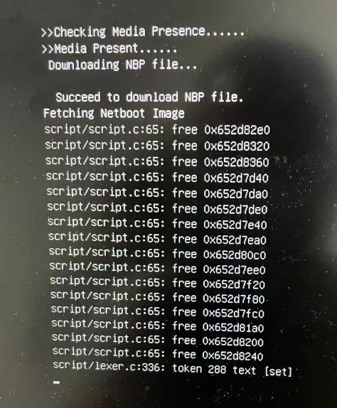

server is SYS-7048GR-TR,mainboard is Supermicro X10DRG-Q

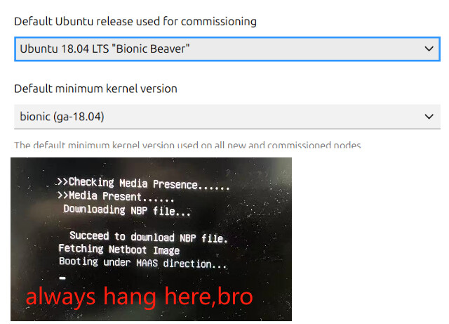

It’s a pretty old one. I’d suggest to try using bionic/focal for commissioning
always hang on there,bro
Please enable the debug mode by editing /var/snap/maas/current/rackd.conf and add debug: true. After that restart MAAS with sudo snap restart maas and check if you get more logs on the console while booting

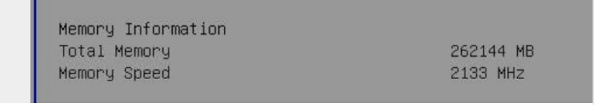

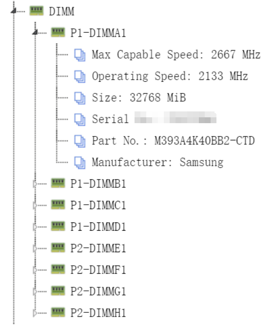

how much memory do you have on this server? Can you check in the BIOS the available RAM?
in fact,this server has a ubuntu 22 in hdd disk and run ok

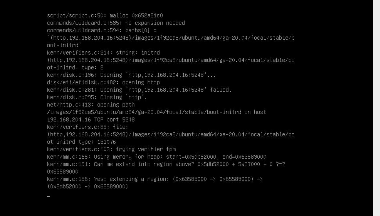

My suggestion would be to
- try to factory reset the server BIOS and update all the firmwares
- try to install ubuntu from a USB stick
- double check the MTU on the MAAS controller node and the switches
Also, if you have another server of another brand you might try to use it, just to exclude a misconfiguration of the MAAS controller node or the network.

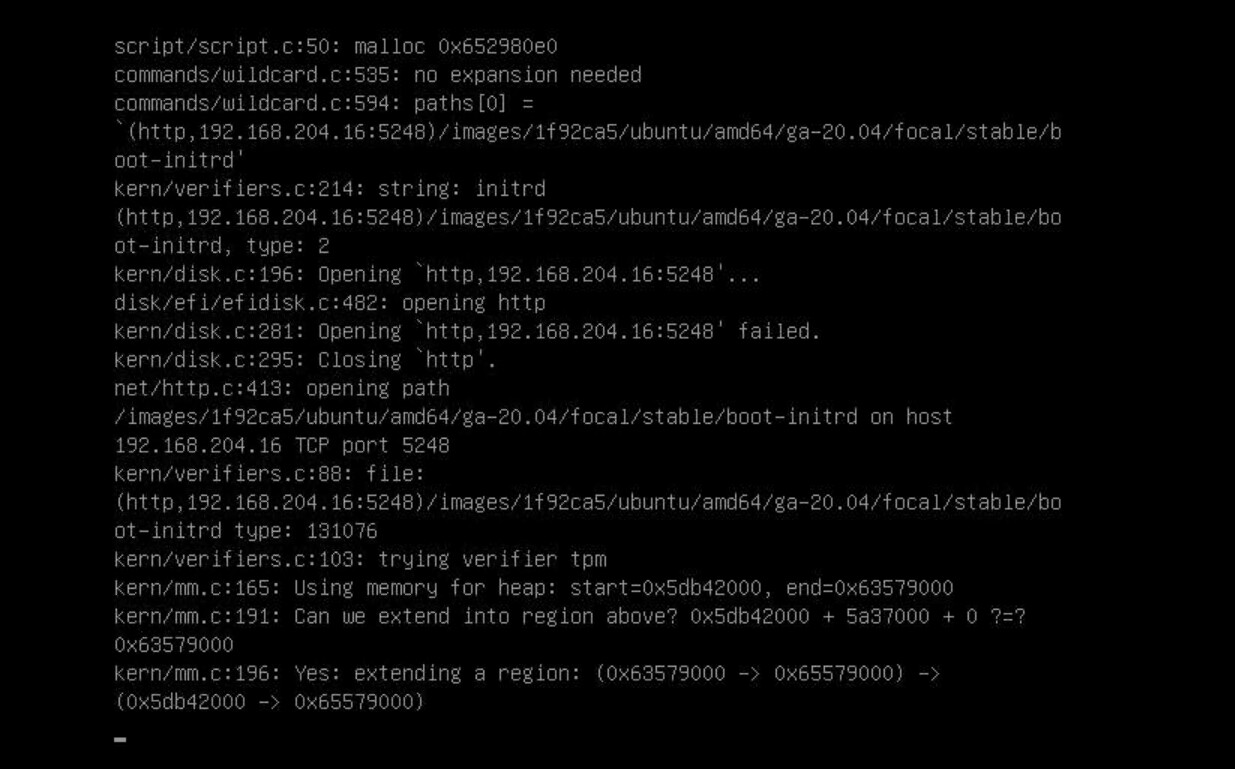

Looks like you have a TPM module. You might try to disable (or update) it from the BIOS
get some tftp error,tftp always some error,first time error,second time ok.
can you help check further
