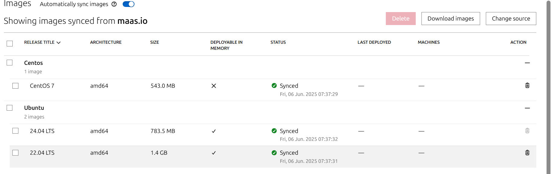

What’s the status of the images in MAAS? Are they still downloading?

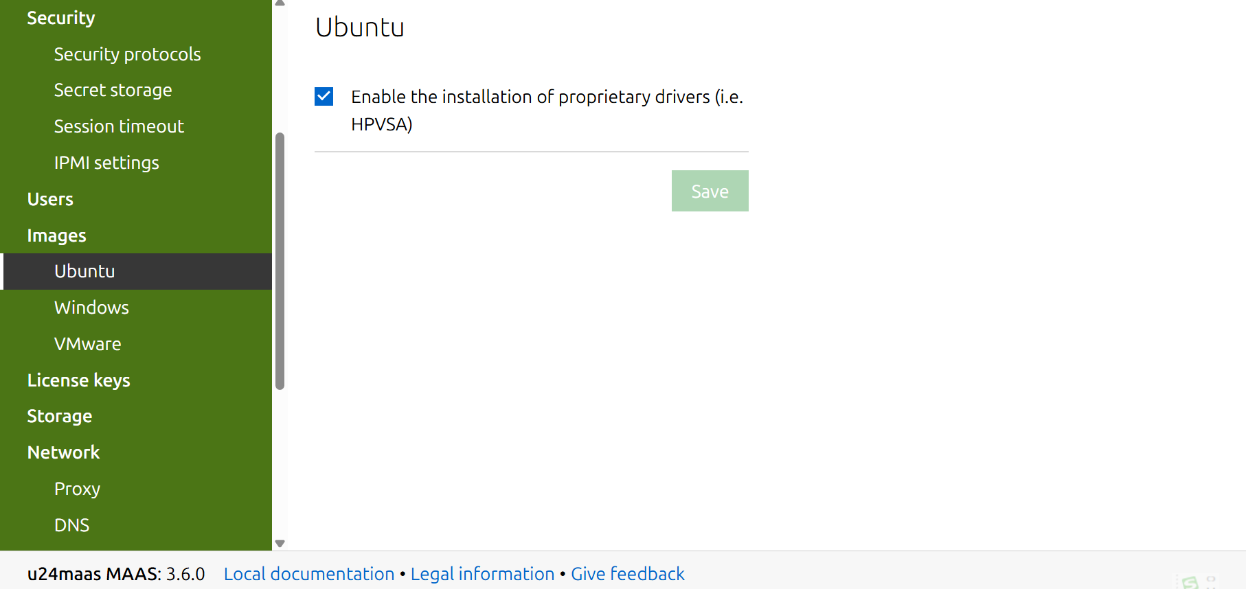

hi,which menu check this,I can not find this
Is it a simple region+rack setup? Or rack and region are on different hosts?
On the UI: Configuration → images
just an option,no image list,should have image list?
yes,just one server
step by step with guide,maas 3.6.0 via snap
Click here bro
sorry for trouble,image is there
