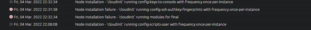

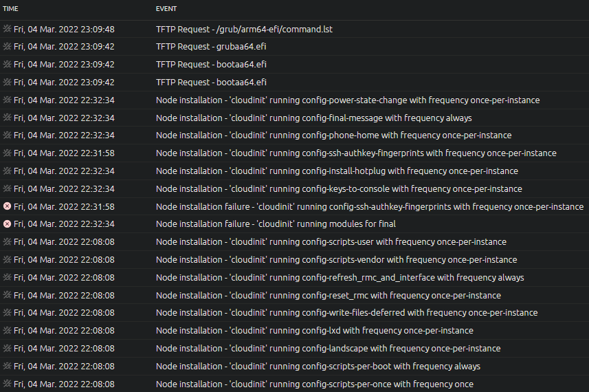

I keep receiving this error even though I am successfully SSHed into the MAAS-provisioned machine. Any idea why this is happening and how I can solve it?
I have seen this bug report but I am not sure how to apply it and if it relevant for my arm64 case. Do I just copy and paste this code into the cloud-init script during re-deployment?
I have attached some logs from the machines as well. Thanks for your time and attention.

calm-fox machine error logs from MaaS UI
Machine not finishing deployment and changing status after deployment.

So is this happening on one machine only? You can get more detailed logs with the Download button on the logging pane, does that tell you anything more?
Yes only on one machine.
This is the only error I see here since machine finishing Configuring OS.
I have attached logs below as well.

Somehow it seems MaaS can’t communicate after deployment to clear the misunderstanding up, because the node is working fine connected as a microk8s master node to the rest of my arm64 cluster.
EDIT: Also I noted that KVM Host is not detected for this machine.
