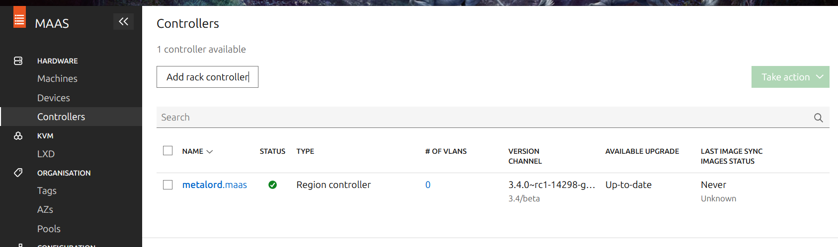

- I only see a single controller in the UI, a region controller (see screenshot below). When I Add rack controller, using the commands given yields a warning/error indicating that the controller has already been initialized. So, I’m convinced that the controller exists but is just not able to communicated with its regional cousin…
