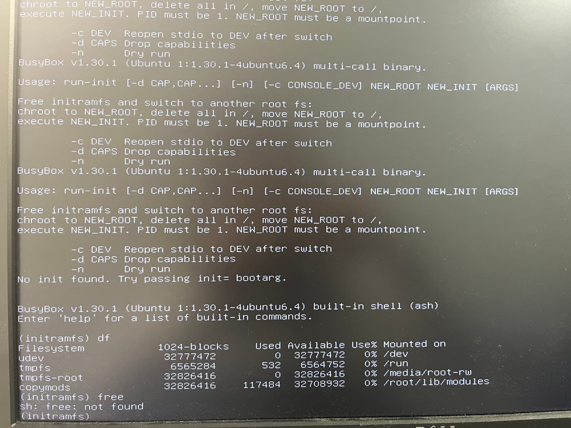

I am commissioning a new machine to my MAAS pool with ubuntu 20.04 image but it turns out to boot into busybox mode (initramfs). The busybox mode does not have fsck command and I have tried to mount the missing proc and sys file but failed to boot as well. I tried to commissioning with Ubuntu 22.04 image and it works fine but I need Ubuntu 20.04 as Ubuntu 22.04 have compatibility issue with my software.

if you end up in initramfs usually you also get a message on the console about what went wrong. Any chance to monitor the boot process?
yeaa… it said no init found. Try passing init=bootarg and chroot to NEW_ROOT, delete all in /, move NEW_ROOT to /, execute NEW_INIT, PID must be 1. NEW_ROOT must be a mountpoint.
I am not so sure what does it mean…

Apart from the rackd log, I have capture log before the PXE boot to the initramfs mode.
The last few lines are:
failure: overlayroot: failed to move root away from /root to /media/root-ro
mount: mounting /dev on /root/dev failed: No such file or directory
ipconfig: no device to configure
ipconfig: BOOTIF: SIOCGIFINDEX: No such device
wget: can’t connect to remote host (MAAS IP Address): Network is unreachable
:: mount -t squashfs -o loop ‘/root.tmp.img’ ‘/root.tmp’
/root.tmp.img: Can’t open blockdev
mount: mounting /root.tmp.img on /root.tmp failed: No such file or directory

I suspect the potential root cause is the image failed to bound to the NIC of my machine.
When I boot with Ubuntu 22.04 image, the eno1 hardware address is available with MACADDRESS mtu 1500 DHCP RARP. However, I receive the cloud-initramfs-dyn-netconf: did no find a nic with MACADDRESS when pxe booting with Ubuntu 20.04
Not sure if Ubuntu 20.04 does not support my UEFI:PXE IPv4 Realtek PCIe 2.5GBE Family Controller…

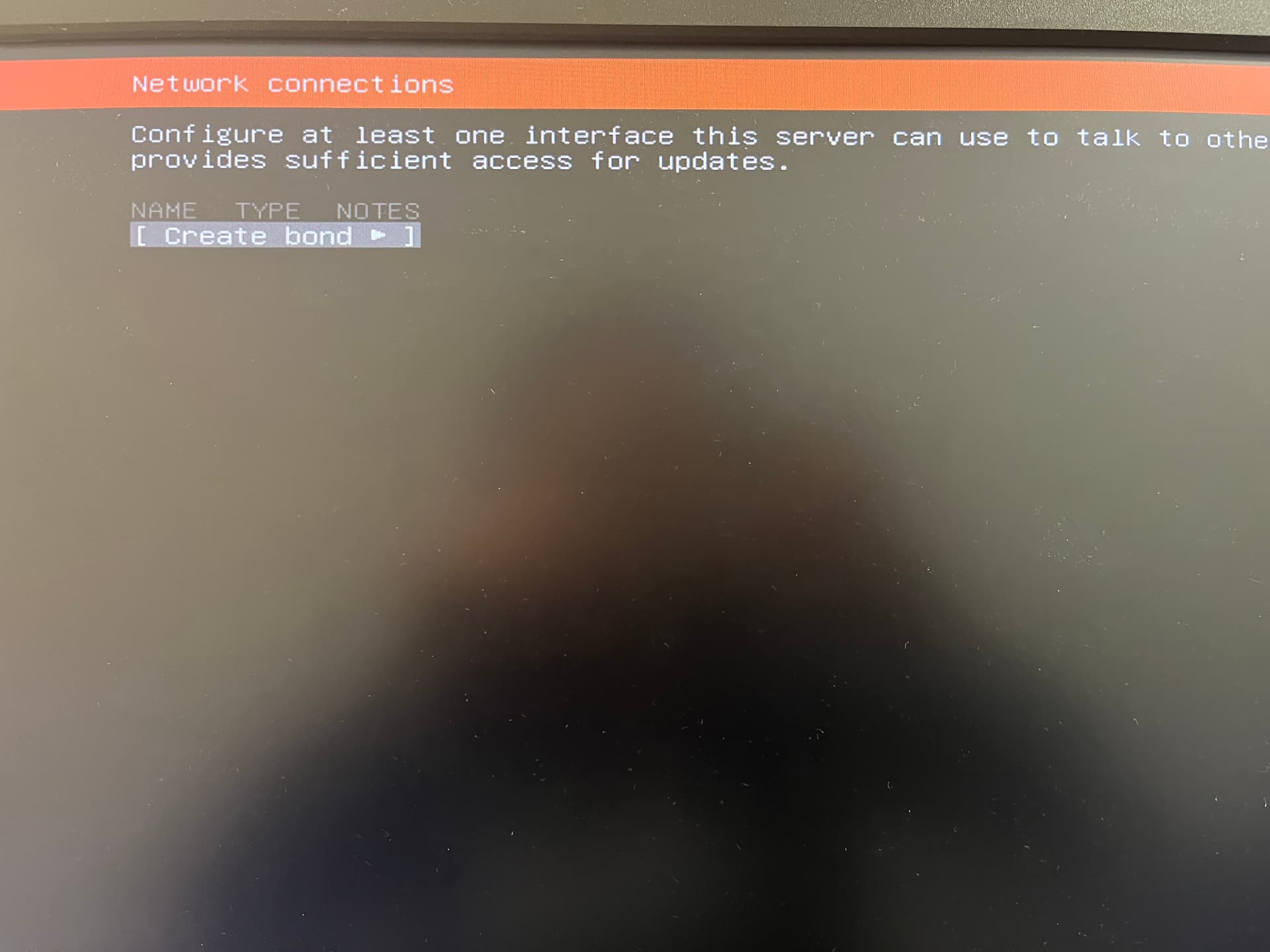

I have tried only to install Ubuntu 20.04 server with USB stick on my machine turns out it did not show the network interface…
