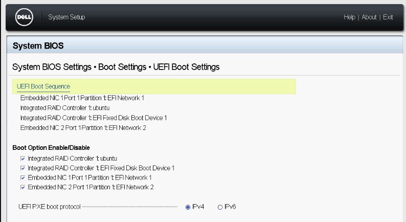

I double check my boot order
I commission the machine, it gathers the correct storage info
Check BIOS, remains unchanged…
I deploy the machine, and get “Failed deployment”, although the machine finishes deployment.
BootCurrent: 0006 Timeout: 0 seconds BootOrder: 0002 Boot0000* EFI Network 1 Boot0001* EFI Network 2 Boot0002* EFI Fixed Disk Boot Device 1 Boot0003* EFI Fixed Disk Boot Device 1 Boot0004* EFI Fixed Disk Boot Device 1 Boot0005* EFI Fixed Disk Boot Device 1 Running command ['udevadm', 'settle'] with allowed return codes [0] (capture=False) TIMED subp(['udevadm', 'settle']): 0.008 Running command ['umount', '/tmp/tmpj7vthvop/target/sys/firmware/efi/efivars'] with allowed return codes [0] (capture=False) Running command ['umount', '/tmp/tmpj7vthvop/target/sys'] with allowed return codes [0] (capture=False) Running command ['umount', '/tmp/tmpj7vthvop/target/run'] with allowed return codes [0] (capture=False) Running command ['umount', '/tmp/tmpj7vthvop/target/proc'] with allowed return codes [0] (capture=False) Running command ['umount', '/tmp/tmpj7vthvop/target/dev'] with allowed return codes [0] (capture=False) Running command ['mount', '--bind', '/dev', '/tmp/tmpj7vthvop/target/dev'] with allowed return codes [0] (capture=False) Running command ['mount', '--bind', '/proc', '/tmp/tmpj7vthvop/target/proc'] with allowed return codes [0] (capture=False) Running command ['mount', '--bind', '/run', '/tmp/tmpj7vthvop/target/run'] with allowed return codes [0] (capture=False) Running command ['mount', '--bind', '/sys', '/tmp/tmpj7vthvop/target/sys'] with allowed return codes [0] (capture=False) Running command ['mount', '--bind', '/sys/firmware/efi/efivars', '/tmp/tmpj7vthvop/target/sys/firmware/efi/efivars'] with allowed return codes [0] (capture=False) Running command ['unshare', '--fork', '--pid', '--', 'chroot', '/tmp/tmpj7vthvop/target', 'efibootmgr', '-v'] with allowed return codes [0] (capture=True) Running command ['udevadm', 'settle'] with allowed return codes [0] (capture=False) TIMED subp(['udevadm', 'settle']): 0.010 Running command ['umount', '/tmp/tmpj7vthvop/target/sys/firmware/efi/efivars'] with allowed return codes [0] (capture=False) Running command ['umount', '/tmp/tmpj7vthvop/target/sys'] with allowed return codes [0] (capture=False) Running command ['umount', '/tmp/tmpj7vthvop/target/run'] with allowed return codes [0] (capture=False) Running command ['umount', '/tmp/tmpj7vthvop/target/proc'] with allowed return codes [0] (capture=False) Running command ['umount', '/tmp/tmpj7vthvop/target/dev'] with allowed return codes [0] (capture=False) Setting currently booted 0006 as the first UEFI loader. New UEFI boot order: 0006,0002 Running command ['mount', '--bind', '/dev', '/tmp/tmpj7vthvop/target/dev'] with allowed return codes [0] (capture=False) Running command ['mount', '--bind', '/proc', '/tmp/tmpj7vthvop/target/proc'] with allowed return codes [0] (capture=False) Running command ['mount', '--bind', '/run', '/tmp/tmpj7vthvop/target/run'] with allowed return codes [0] (capture=False) Running command ['mount', '--bind', '/sys', '/tmp/tmpj7vthvop/target/sys'] with allowed return codes [0] (capture=False) Running command ['mount', '--bind', '/sys/firmware/efi/efivars', '/tmp/tmpj7vthvop/target/sys/firmware/efi/efivars'] with allowed return codes [0] (capture=False) Running command ['unshare', '--fork', '--pid', '--', 'chroot', '/tmp/tmpj7vthvop/target', 'efibootmgr', '-o', '0006,0002'] with allowed return codes [0] (capture=False) Invalid BootOrder order entry value0006 ^ efibootmgr: entry 0006 does not exist Running command ['udevadm', 'settle'] with allowed return codes [0] (capture=False) TIMED subp(['udevadm', 'settle']): 0.010 Running command ['umount', '/tmp/tmpj7vthvop/target/sys/firmware/efi/efivars'] with allowed return codes [0] (capture=False) Running command ['umount', '/tmp/tmpj7vthvop/target/sys'] with allowed return codes [0] (capture=False) Running command ['umount', '/tmp/tmpj7vthvop/target/run'] with allowed return codes [0] (capture=False) Running command ['umount', '/tmp/tmpj7vthvop/target/proc'] with allowed return codes [0] (capture=False) Running command ['umount', '/tmp/tmpj7vthvop/target/dev'] with allowed return codes [0] (capture=False) finish: cmd-install/stage-curthooks/builtin/cmd-curthooks/install-grub: FAIL: installing grub to target devices finish: cmd-install/stage-curthooks/builtin/cmd-curthooks/configuring-bootloader: FAIL: configuring target system bootloader finish: cmd-install/stage-curthooks/builtin/cmd-curthooks: FAIL: curtin command curthooks Traceback (most recent call last): File "/curtin/curtin/commands/main.py", line 202, in main ret = args.func(args) File "/curtin/curtin/commands/curthooks.py", line 1770, in curthooks builtin_curthooks(cfg, target, state) File "/curtin/curtin/commands/curthooks.py", line 1736, in builtin_curthooks setup_grub(cfg, target, osfamily=osfamily) File "/curtin/curtin/commands/curthooks.py", line 701, in setup_grub uefi_reorder_loaders(grubcfg, target) File "/curtin/curtin/commands/curthooks.py", line 462, in uefi_reorder_loaders in_chroot.subp(['efibootmgr', '-o', new_boot_order]) File "/curtin/curtin/util.py", line 708, in subp return subp(*args, **kwargs) File "/curtin/curtin/util.py", line 275, in subp return _subp(*args, **kwargs) File "/curtin/curtin/util.py", line 141, in _subp cmd=args) curtin.util.ProcessExecutionError: Unexpected error while running command. Command: ['unshare', '--fork', '--pid', '--', 'chroot', '/tmp/tmpj7vthvop/target', 'efibootmgr', '-o', '0006,0002'] Exit code: 8 Reason: - Stdout: '' Stderr: '' Unexpected error while running command. Command: ['unshare', '--fork', '--pid', '--', 'chroot', '/tmp/tmpj7vthvop/target', 'efibootmgr', '-o', '0006,0002'] Exit code: 8 Reason: - Stdout: '' Stderr: '' -
Check BIOS again, boot order is different

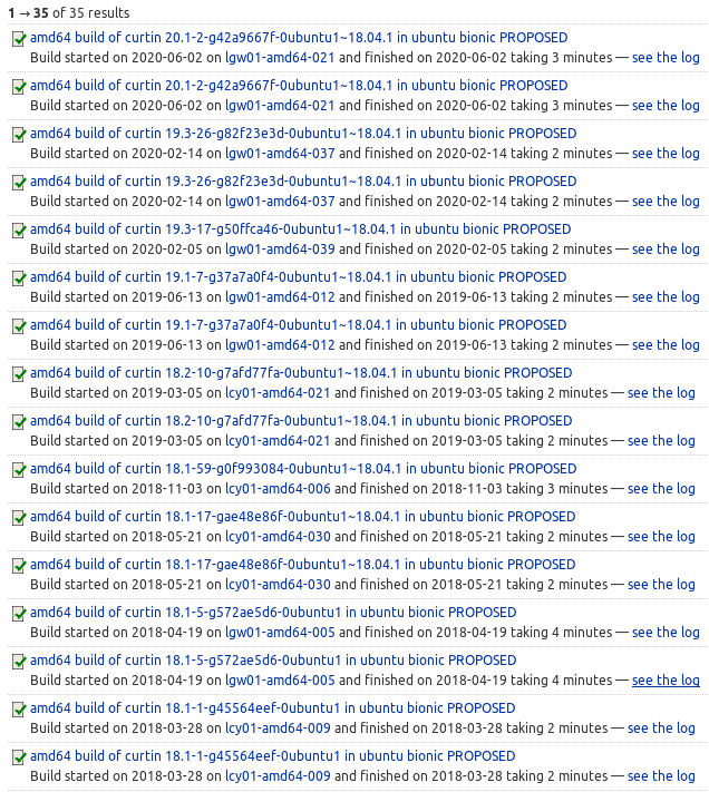

One of the bug reports say that a fix has been released for curtin:
I’m running 2.8
