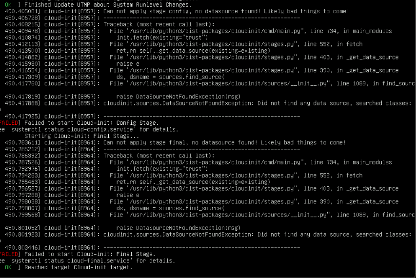

Hi there,
When Deploying a baremetal with Libvirt enabled, I get this error on the output, “Cloud Init Final Stage, no datasource found” and it won’t complete the deployment. I also can’t SSH into the box, but I can ping the interfaces.
If I deploy baremetal without Libvirt support, it completes the deployment and I can SSH into the box.
Not sure what’s going on when MAAS creates those network bridges for Libvirt, I tried with 20.04 and 24.04, same problem.

I encounter a very similar issue but not related to libvirt in any way.
I’m deploying a new cloud based on MaaS 3.6 (snap edition) on top of Ubuntu 24.04 nodes (I had one based on MaaS 3.1/Ubuntu 20.04 before).
When deploying machines with a LACP bond with MaaS, once the machine is installed and it reboots to enable the new configuration (hence, the LACP bonded network), it seems the OS don’t has access to the network as if it was unplugged.
This makes downloadind MaaS meta data fail and make cloud-init crashes at the end of the process with the same error that we can see in @mk4umha screenshot.
Worst than that, this makes network services such as SSH fail and there is no way to connect to the machine once booted.
What is even more weird is the fact that L2/L3 network is up since I can ping this newly deployed machine from the MaaS node !
But, as for @mk4umha , there is no feedback to MaaS and deployment for this machine remains stuck in “Rebooting” status.
