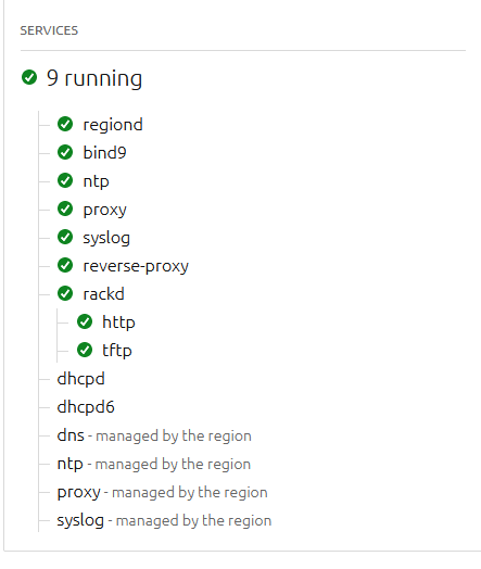

I am trying to launch MaaS 3.3 on a Single VM (both rack and region controllers) with the new ansible playbook scripts which worked ok but the DHCPD server doesn’t seem to be running:
Although DHCP is enabled for the VLAN:
Also no process listening on port 67 on the maas vm.
Network wise everything is great because if i down this VM and bring up another one I had with version MaaS 3.1 everything is working as it should.
