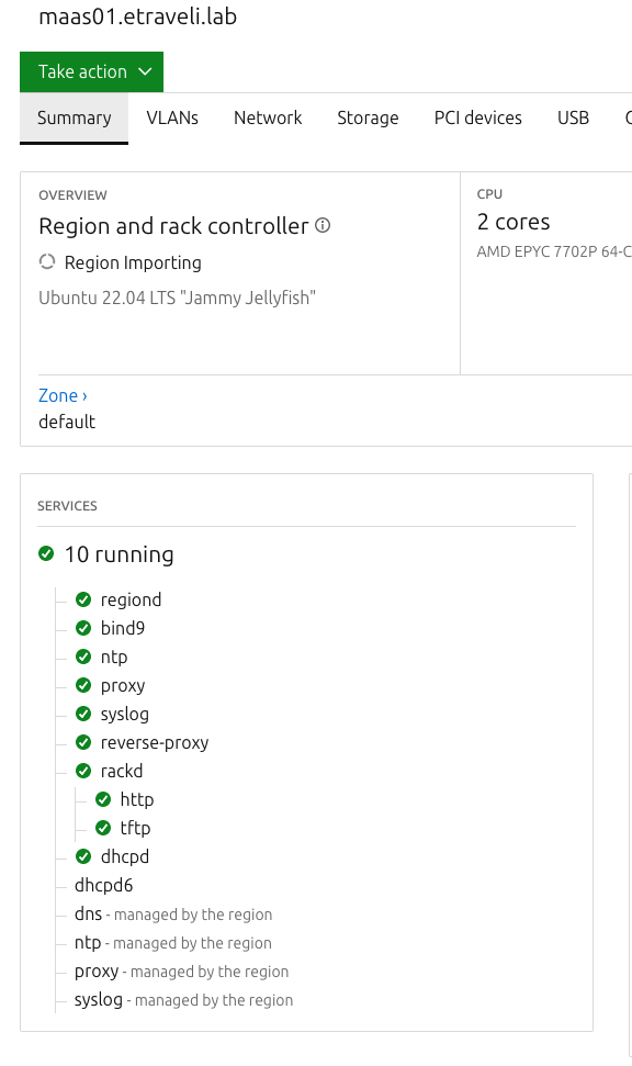

I am currently trying to deploy a maas instance in our lab environment with maas-ansible-playbook. The maas-servers in question are running Ubuntu 22.04. I am using deb installation and have tried with both version 3.3 and 3.4, the deployment works fine but after adding DHCP to one or multiple VLANs the maas-dhcpd service does not start.
This has been observed both here on the forums and been raised as an issue in the github repo linked above. I wrote a comment on that issue with more details
How can we solve this within the playbooks available? I am currently deploying a new instance to see if the case is the same using snap installation, however i want to use deb in our lab since that is what we use in production today.
Deployed with ansible again but using snap instead of deb, now the services is active on both my rack controllers.

Going back to the issue, it can happen because the rack controller is having problems creating some DHCP files used during the configuration.
Could you please provide some logs (maybe through journalctl) when running the installation using deb? If we see some errors related to a dhcpd-interfaces or dhcpd.conf files while running the deb installation, we can narrow down the problem.

I will do some more testing with deb and check the installation logs to see if i can catch any errors. If solvable with me i will add them to git aswell
