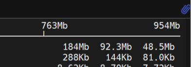

In our case we have separate regiond and rackd. I also added this property httpproxy_cache_size: 20000000000 # 20GB in bytes
i can see the image is fetched from regiond on 2nd time deployment.
Regiond > Rackd (from iftop)
From Rackd to target machine
Please note that am using a custom image !
Hmm. Are you sure it downloads the full image? MAAS currently cannot cache the bootloader, so it there will be some traffic between machine and the regiond.
