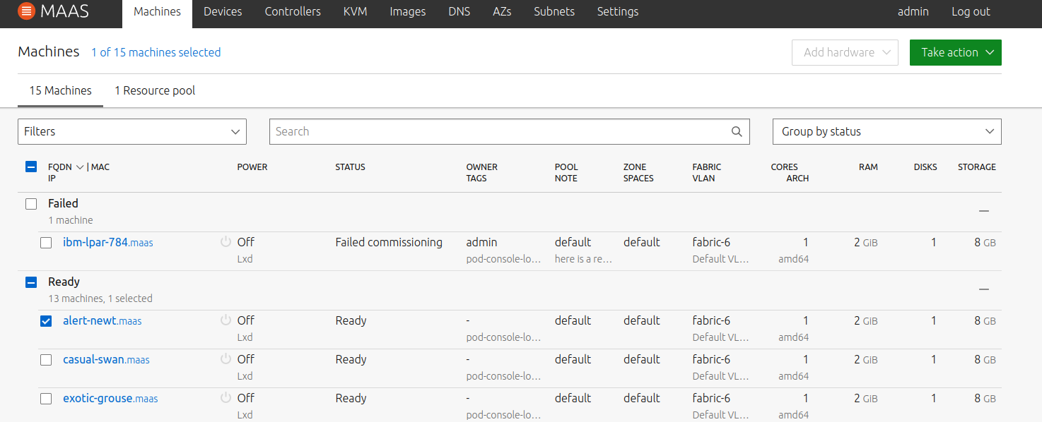

  1. Go to the machine list and select the machine you’re interested in modifying, by checking the box next to the machine name:

In the first step of the above procedure, you can select more than one machine:
Any tags you add in the “Tags” box will be applied to all selected machines, as noted by the change in the “Tag machine” button:
