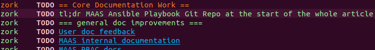

There should really be a link to the Git Repo itself in the main how to article, right?
It wont allow me to edit the main article because of the number of links in it, but i propose:
tl;dr MAAS Ansible Playbook Git Repo
at the start of the whole article, at the bare bare minimum.
Thanks!
yep, will work on that this afternoon
yep, this page was a mess. sorry about that. see how it feels now.
