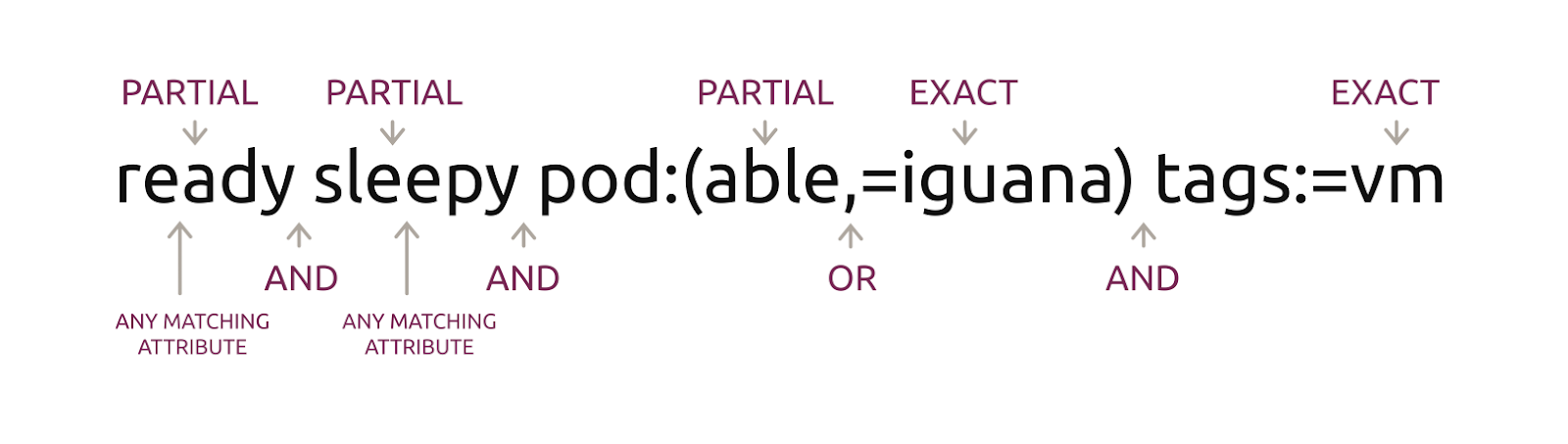

Here’s how a typical MAAS search parameter looks:
Search attributes go into the Search box, separated by spaces for ‘AND’ logic, or enclosed in parentheses and divided by commas for ‘OR’ logic. They generally follow the format parameter-name:. You can fine-tune matches using ‘=’ for exact and ‘!’ for negations. The UI filter drop-downs also help you understand how these work.

Exact and partial matching
For exact matches, prefix the search value with ‘=’. For partial matches, omit it. For example:
Exact: pod:=able-cattle
Partial: pod:able,cattle
Using multiple search terms
MAAS uses ‘AND’ logic by default for multiple terms. For instance, pod:able,cattle cpu:=5 will show machines in pods named able or cattle with 5 CPU cores.
