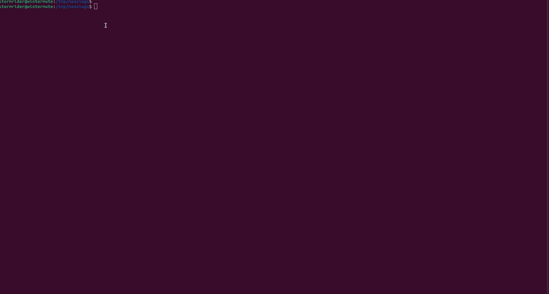

If you want to e-mail them, please compress the logfiles into a tar.gz file for efficient upload transmission. The following animation shows a recommended process for creating a tar.gz file. The mistakes are intentional, so that you’ll know what to do if you forget an option now and then, or forget to use sudo in a step or two:
