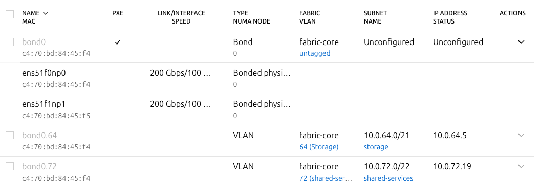

Whenever a machine host multiple IP addresses, the logic of which IP address gets assigned to the machine’s main DNS record (hostname.domain-name) is murky and seems to lack controls. This was raised here earlier. It was said in that topic that MAAS will assign the IP address of the boot interface to the DNS record. However, this breaks down especially in bonded scenarios. Take for example this scenario:
Here the PXE boot happens on NIC ens51f0np0 over the default VLAN. During OS installation, the above config gets populated into the netplan config for after the reboot. We don’t leave a PXE IP address in this config and both NICs are bonded. The machine’s primary IP is 10.0.72.19 and it has an additional storage IP (10.0.64.5).
Originally the storage subnet also defined DNS servers, which seems to cause that IP to be included in the list of IPs that MAAS can pick from for the main DNS record. I have since cleared that configuration, now the 10.0.64.x subnet no longer sets any DNS config and that seems to have removed the possibility that new servers can have an IP from this subnet set to the main DNS record for the server.
However this server above was deployed before that change was made, and it resulted in a main DNS record of 10.0.64.5, which is not desired.

Is there any logic to how MAAS decided on the IP address to use for the machine’s main DNS record?
In your case you have a bond on the pxe interface with some vlans, in this case MAAS should pick the interface ID with the lowest id.
