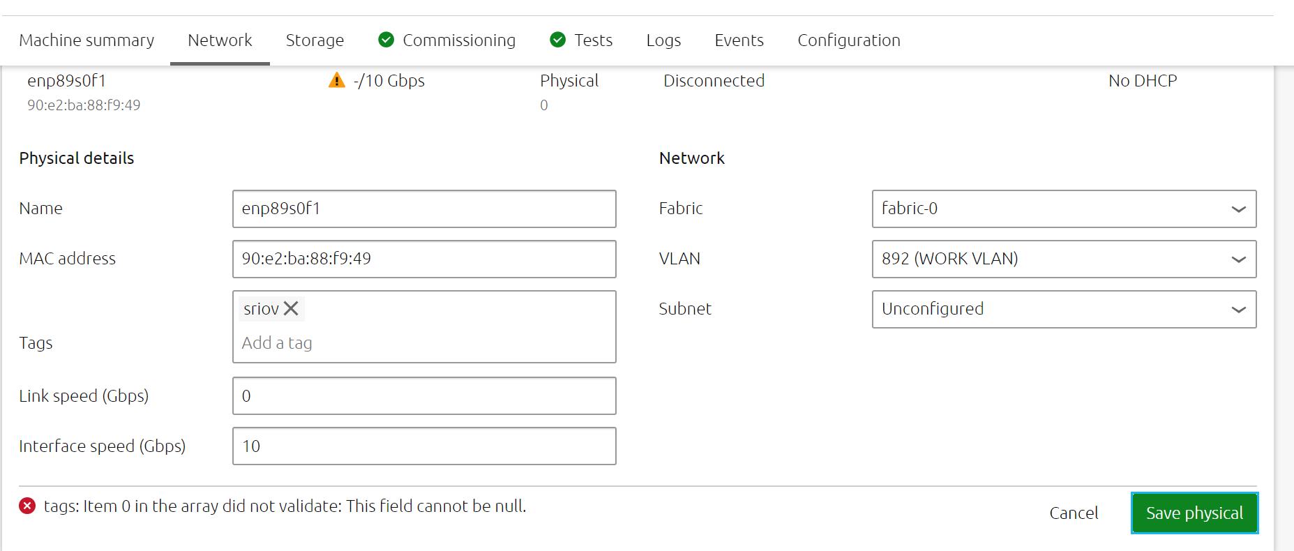

When I click save physical button, I get the following error:
tags: Item 0 in the array did not validate: This field cannot be null
MAAS version: 2.7.0
Can anyone tell me what that error means and possible how to address it?
Thanks

I am having the same issue, I installed the new MAAS 2.7 and now upgrade it to MAAS edge version: 2.7.0 (8234-g.de2727f6c)
I can’t find the way to change any of the network interfaces
I came here to ask about this same issue. I installed MAAS 2.7.0 (8234-g.de2727f6c) on a brand-new system. This was not an upgrade from a previous version. I installed MAAS using snap. I get this error when the machine is in the New or Ready state. The relevant part from regiond.log is:
2020-02-26 23:47:15 maasserver.websockets.protocol: [critical] Error on request (1059) machine.update_interface: {“tags”: [“Item 0 in the array did not validate: This field cannot be null.”]}

django.core.exceptions.ValidationError: {‘tags’: [‘Item 0 in the array did not validate: This field cannot be null.’]}
I submitted a bug report for this here: https://bugs.launchpad.net/maas/+bug/1864241
Thanks everyone for bringing this up and submitting the bug, the MAAS-UI team will look into it.
