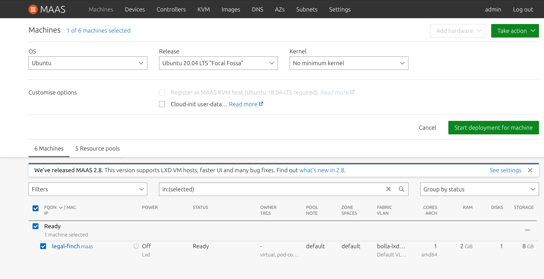

Customising cloud-init with the UI (v2.9++)
It’s easy to customize cloud-init via the web UI. When you’ve selected a machine and choose ‘Take action >> Deploy,’ you’ll be presented with the following screen:
Select a viable release (in this case, “Ubuntu 18.04…”) and check the box labeled “Cloud-init user-data…”:
Paste the desired script directly into the box, and select “Start deployment for machine.” For example, to write a file immediately after your machine deployment, you could paste this script:
