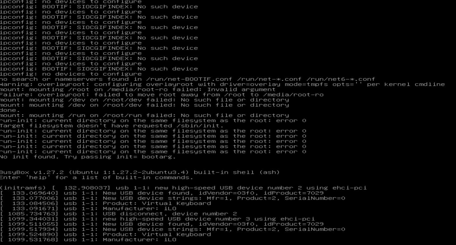

But if I try to deploy an official Ubuntu 18.04 or 22.04 image it doesn’t work. (with the same server, same settings everywhere). The process status gets stuck on performing PXE boot as per below:
18.04 Error Example
22.04 Error Example
I have already tried with multiple MaaS Versions like 3.4/edge, 3.2/stable but it is no different. 20.04 always works flawlessly 18.04 and 22.04 don’t.

Hi @jonaspaulo ,
Could you please take a look at the rackd logs and check if is there anything there?
The error for 18.04 seems similar to something another user reported recently MAAS PXE boot Ubuntu 20.04 image and failed with busybox - #8 by lindaor15

Just some more detail.
I thought that the issue could be with the image downloading or something since the image version that always worked across multiple MaaS versions was the default one that is included (20.04).
But I tried with some more Ubuntu versions downloaded after Maas Installation and here are the results (always maintaining the same setup, settings and repeatable tests (multiple deploys releases and achieving the same result):
  • Ubuntu 23.04 - Works
  • Ubuntu 23.10 - Works
  • Ubuntu 22.10 - Doesn’t work (same errors as 22.04)
Thanks a lot.
Hey @jonaspaulo,
I wonder if you can capture the same console output for a 20.04 boot. Is there something obvious that happens there that doesn’t happen in the other versions?
I would guess that commissioning with 22.04 or 18.04 would also fail but it might be useful to check.
Another thought I had was you might have a custom curtin_preseed for 20.04 but not other versions. But I don’t think you’re getting far enough for that to matter.
Is this restricted to a specific server or is this behavior with all servers you deploy?
I would want to see more of the failed deployments’ console output. If you could screen-record the boot process, perhaps you’ll see an error earlier in the process that will give some hints.
Not sure what’s going on, these are just my initial thoughts on the problem.
Cheers,
Vern

Before doing anything - I think this might have something to do with Bug #2016908 “udev fails to make prctl() syscall with apparmor=0...” : Bugs : maas-images.
I’d like to try that new kernel first. How can I do this?
I confirm that with ubuntu 23.10 it works perfectly. It most likely is due to the bug I linked in the previous comment.
