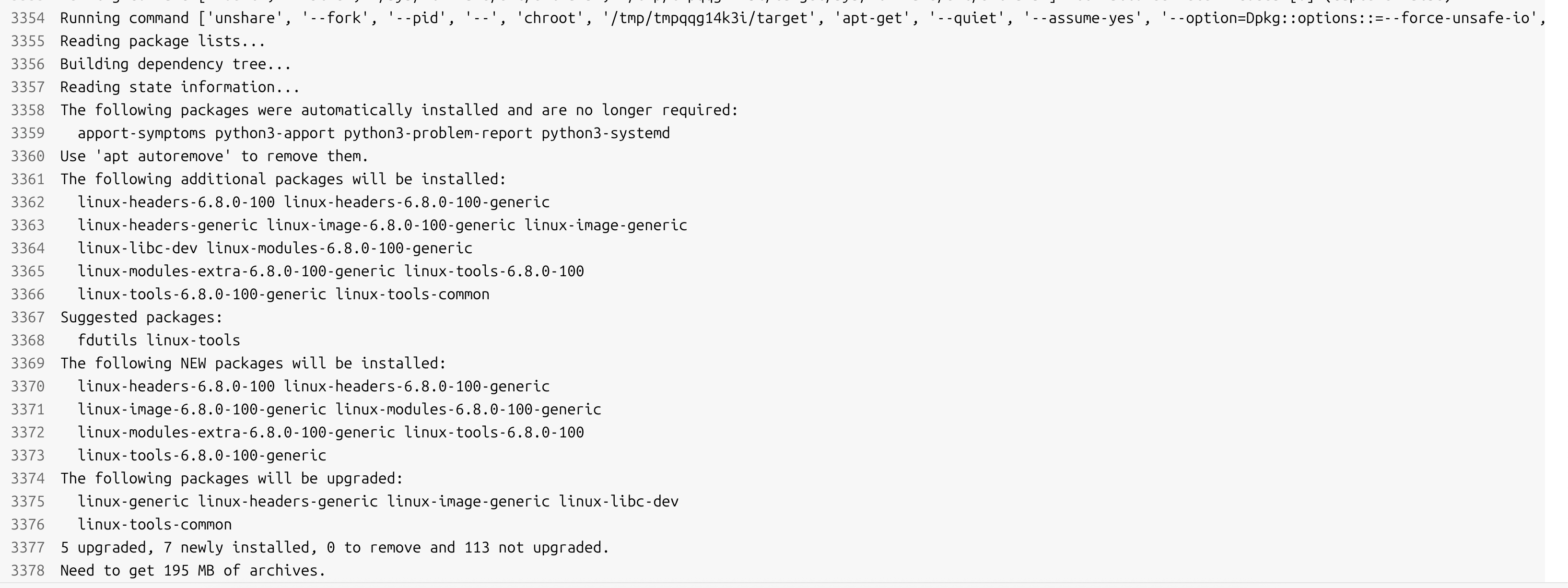

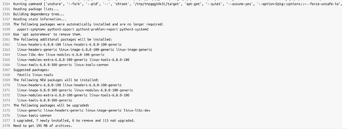

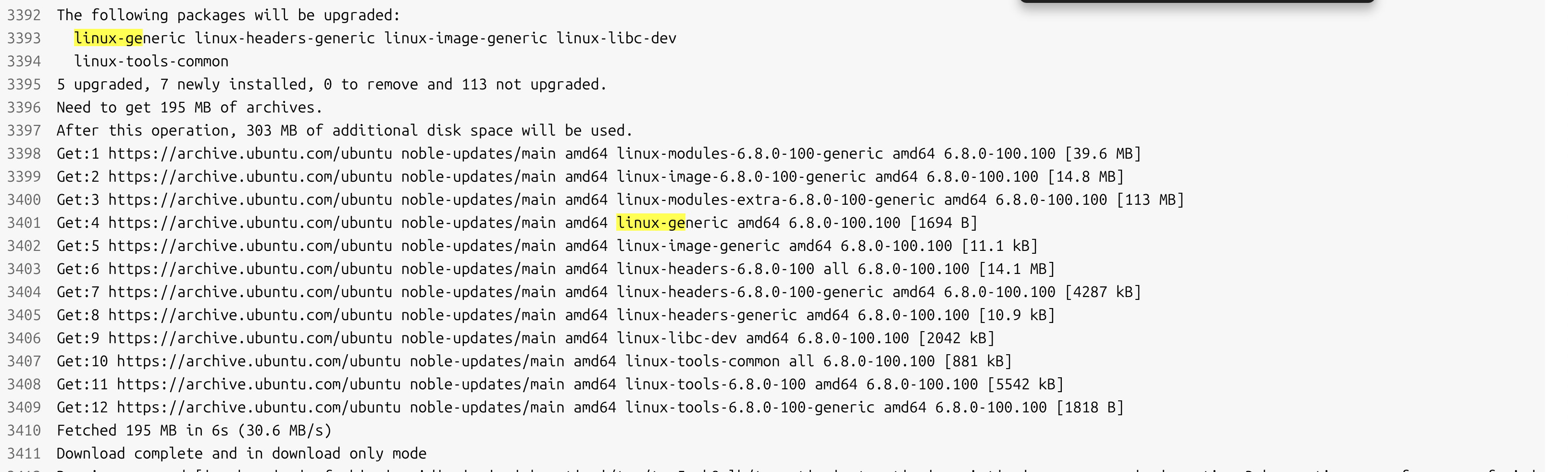

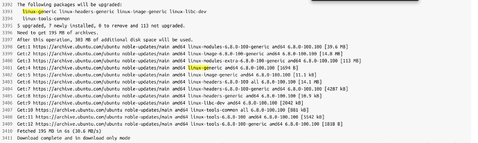

we are also facing similar issue, our custom image is having linux-headers-6.8.0-88 kernel, when we deployed the server with custom image.. curtin is automatically upgrading the kernel to latest available one from internet which is linux-headers-6.8.0-100 in my case , this is creating issue while installing nvida drivers on our servers, please guide us how we can stop curtin to not install kernel during server deployment
@akashram611 it looks like you’re not setting the curtin userdata correctly, since MAAS is still just installing the linux-image-generic package during your installs. That is what’s causing the upgrade.
When you have the curtin userdata correctly configured with a pinned kernel version, the logs no longer show the linux-image-generic package getting installed at all. Instead, only your pinned version gets installed:

Verify you’re placing the curtin file in the correct location and with the correct name for the image you’re deploying.
