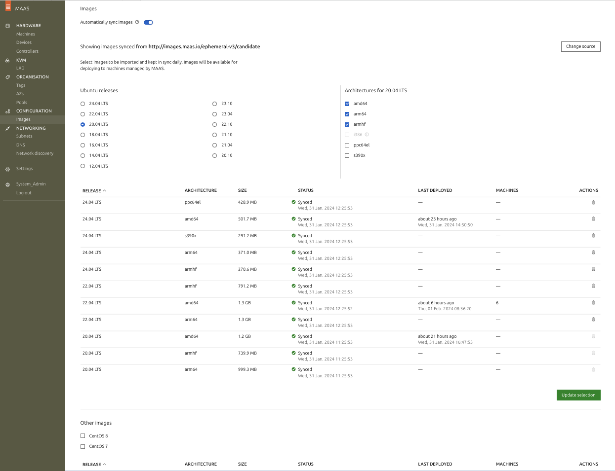

could you please make a screenshot of the images page in the UI?
Here is the screenshot:

@na88nar what arm64 machines do you have? We saw issues with Ampere servers where firmware is not behaving correctly.
We ended up using older grub and bootstrap files as a workaround.
