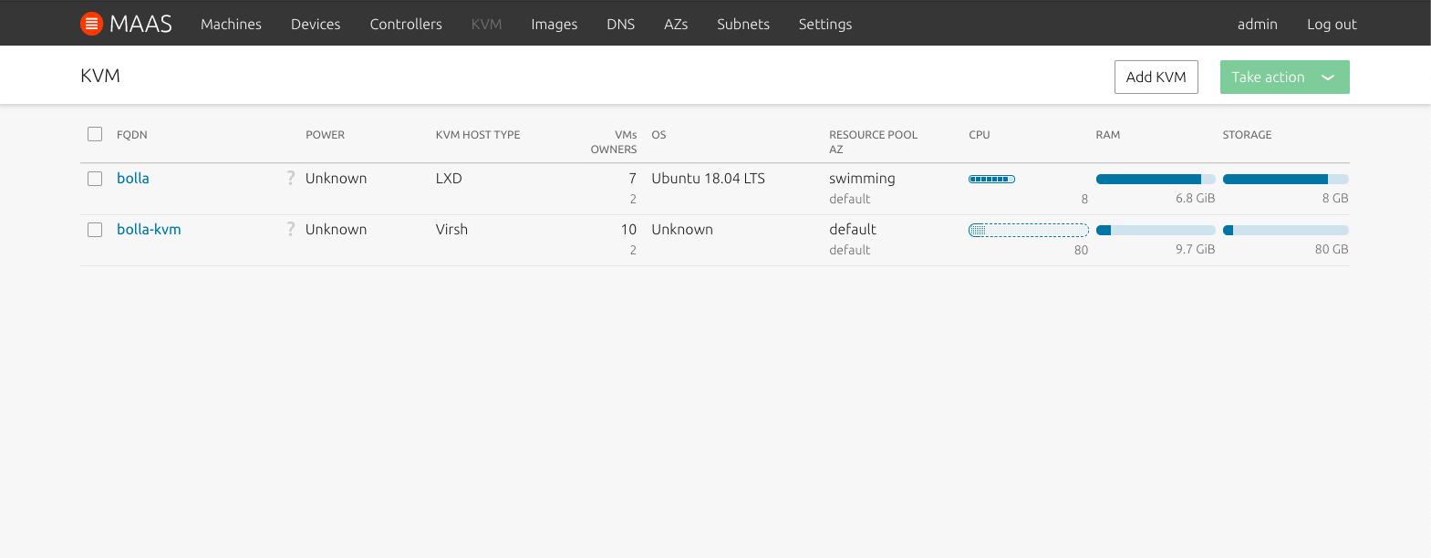

List VM-hosts
To begin, you can list your avsailable KVM-hosts with the following command:maas admin vm-hosts read | jq -r '(["ID, "VM-HOST","SYSID","CORES",
"USED","RAM", "USED","STORAGE", "USED"] | (., map(length*"-"))),
(.[]| [.id,.name,.host.system_id,.total.cores, .used.cores, .total.memory, .used.memory,.total.local_storage, .used.local_storage])
| @tsv' | column -t
This command is in the CLI cookbook as lsvmh
