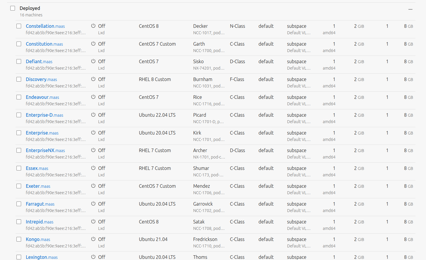

There are two types of custom images we’ll explain here: static Ubuntu images (just below) and packer images.
About static Ubuntu images
MAAS provides the capability for you to build a static Ubuntu OS image to deploy with MAAS, using any image-building method you choose. You can create the image once, with a fixed configuration, and deploy it to many machines. This fixed configuration can consist of anything that a normal image would contain: users, packages, etc. This capability is really targeted at older versions of MAAS, but it should work with MAAS of any vintage.
There are five things that we should explain about static Ubuntu images:

If you’re using newer versions of MAAS (>3.0), we recommend choosing packer, since the packer-maas repository already has a built-in Ubuntu image you can customise – but the choice is yours.
