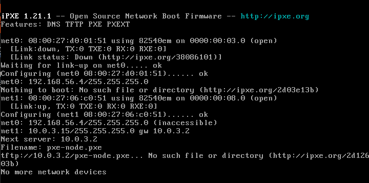

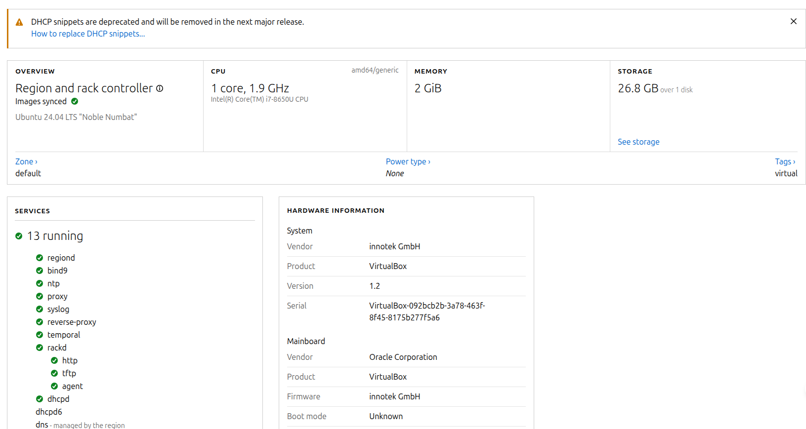

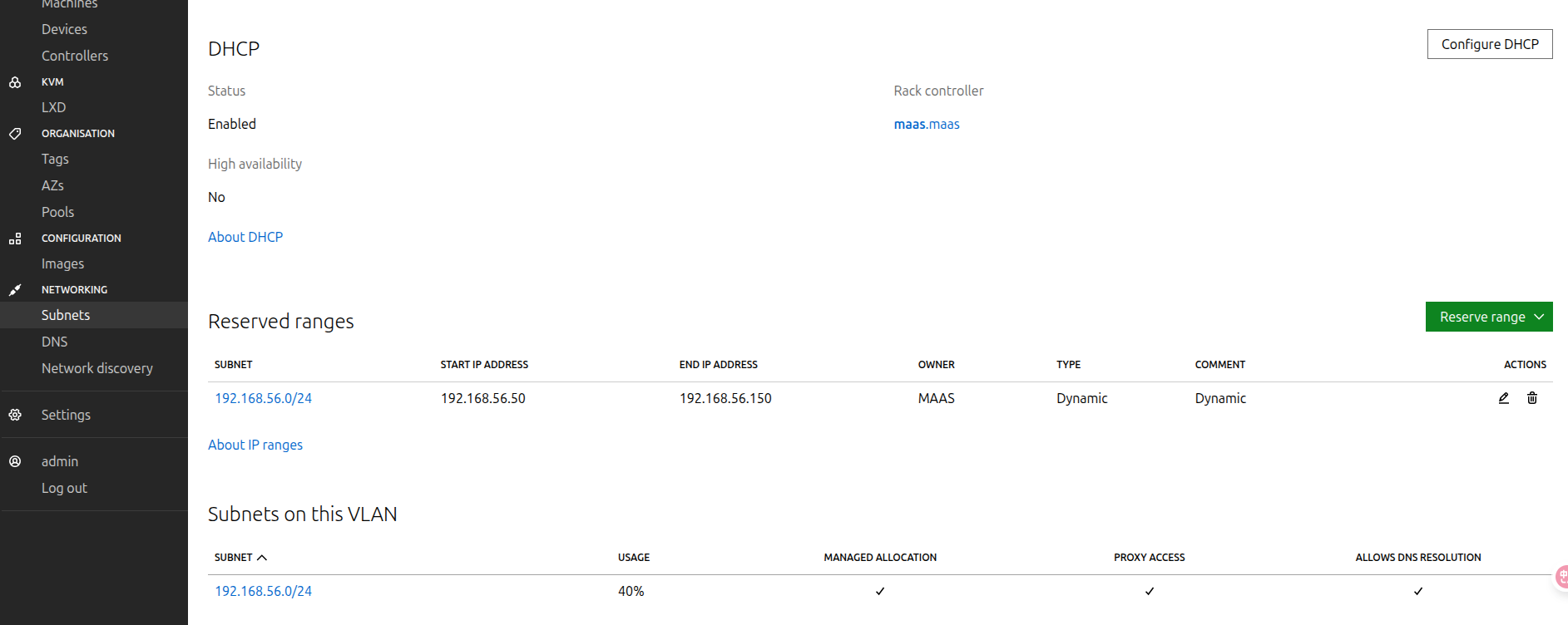

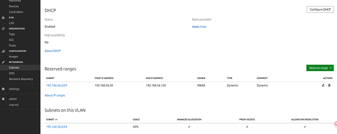

I am using Ubuntu 22 system locally, installing VirtualBox, and using two virtual machines. One uses Ubuntu 24 system and installs MAAS, and the other uses PXE startup. MAAS installation is normal. Both virtual machines have been added (host only), but they have not started successfully. Please help me.
looks like you have another DHCP server on 192.168.56.0/24. If this is the case please keep only the DHCP server of MAAS (or keep only the other one, but you have to configure it accordingly Show and Tell: Using external DHCP with MAAS)
