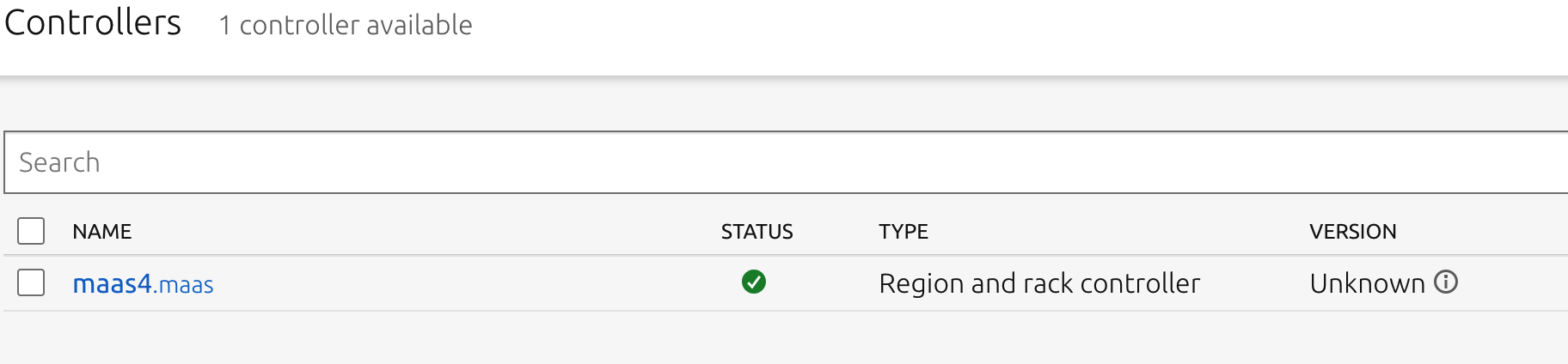

MAAS Controller version unknown (PCI and USB devices is not found on MAAS Dashboard)
but, No problem with a New installation of MAAS 3.
How can I successfully upgrade MAAS?

Hi ytooyama-virtualtech ,
your upgrade procedure seems right. Could you please check /var/log/maas/maas.log,
/var/log/maas/regiond.log and /var/log/maas/rackd.log for errors?
About the missing PCI and USB devices, MAAS needs to re-commission the machines to get that information. This action is not automatic, user action is required.
I will try again. and check the logs.
Thank you for your comment. I was mistaken.
I tried again, and I was able to upgrade without error. It might have been better to wait after the upgrade.
