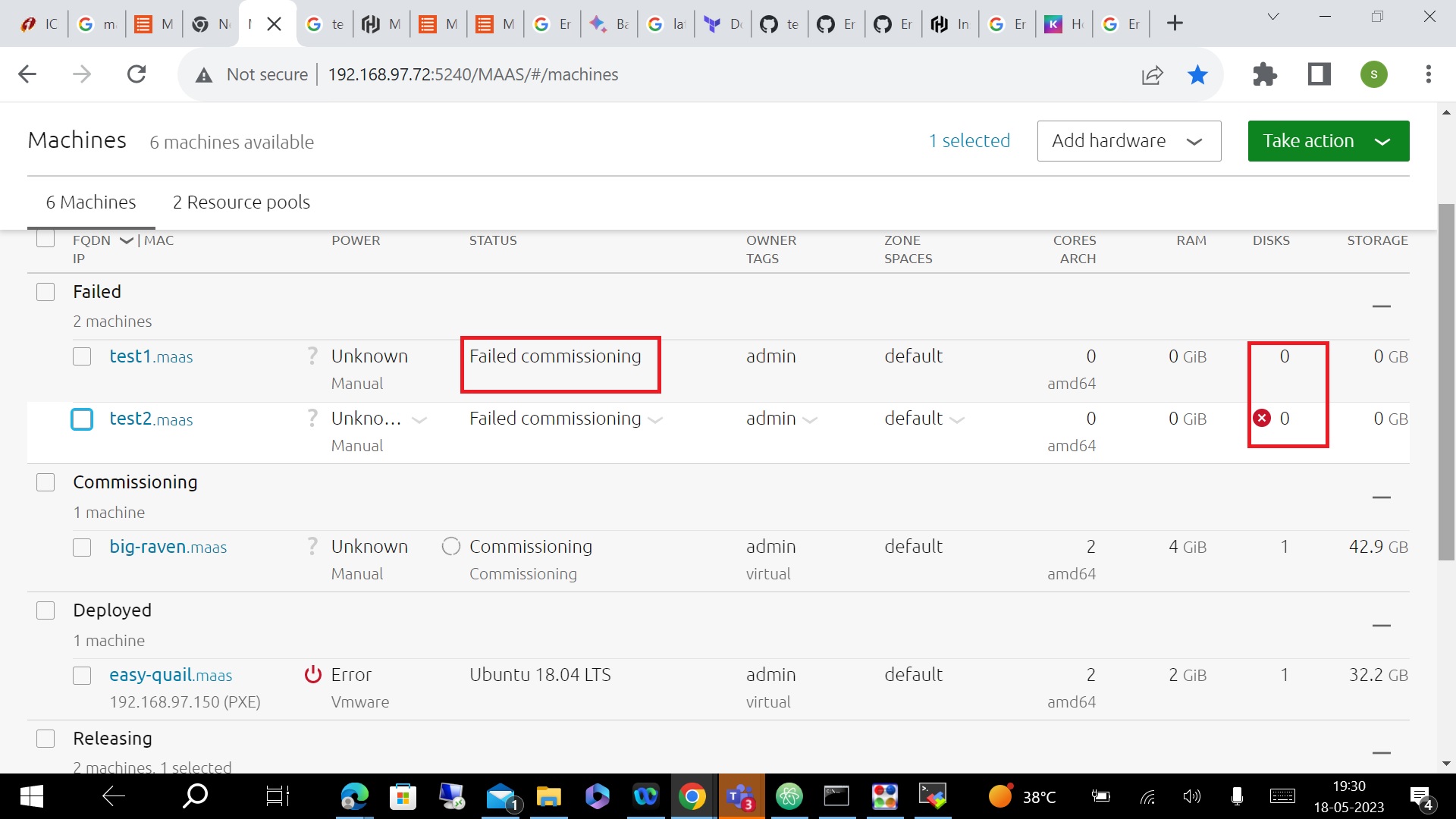

Meanwhile we also tried to deploy machine from mass UI, but its failing, pls see attached screenshot.
It failed in “commissioning” state.
@vinodsiraparapu I do strongly recommend to go through documentation and to get familiar with maas CLI usage.
$PROFILE in my example was referring your profile name used during maas login
@sudhirnigam I would recommend you to check the errors that happened during commissioning and also check MAAS logs
Hi @troyanov
Thank you so much for your help.
As discussed, I am trying with MAAS cli and failed with commissioning and allocate … please find the logs and suggest to successfully deployed the machine on MAAS.
Please find the logs: I have observed the machine do not find any resources allocated like RAM, CPU.

ubuntu@ubuntu:~$ maas admin machines allocate system_id=cqbp36
No available machine matches constraints: [(‘system_id’, [‘cqbp36’])] (resolved to “system_id=cqbp36”)
Based on the description you provided, it appears that you are trying to allocate machine that is not in the required state.
Some suggestions to troubleshoot the issue further:
Did you follow this How to allocate machines guide? It mentions that node should be in state Ready before you can allocate it.
To allocate a node, it must have a status of ‘Ready’.
You have to wait for the Commission process to complete. If there are any errors, you can navigate to machine details and check the status of Commission steps and view logs to analyze failures (if there are any)
We also have a collection How to troubleshoot MAAS that might help you to identify your issue.
Hello @vinodsiraparapu @sudhirnigam
I am wondering if you were able to solve your Terraform issue? And maybe you can share back with the community how you solved it?
