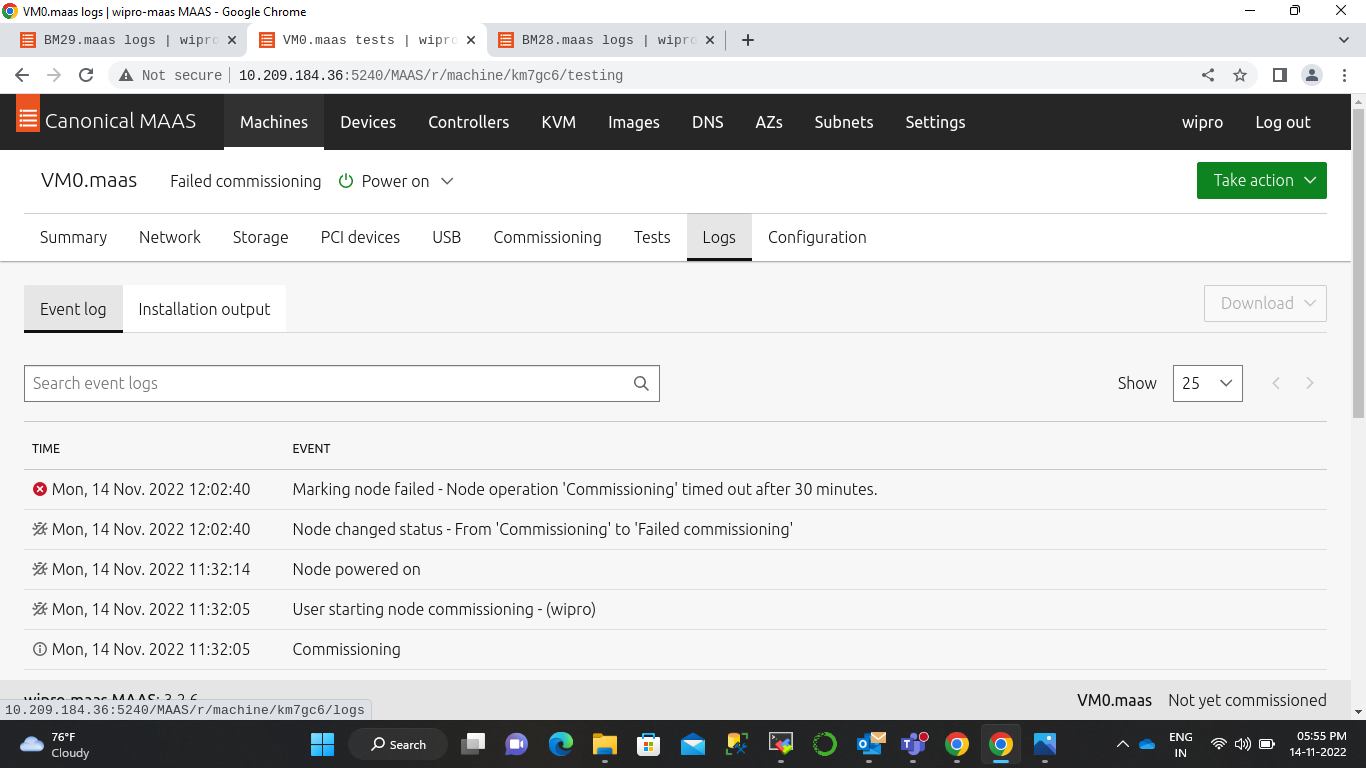

I am using MAAS 3.2.6 and created a bare-metal node using standard bridge with network interface having pxe boot enabled, but VM was not commisioned and error was time-out error after 30 mins.
Any help will be appretiated
@lovekush-sharma, a bit more info about your network setup would help. you created a bare-metal node using a standard bridge with a network interface. then you tried to use that bare-metal node as a VM host?
The issue is resolved now, the issue was we did not add baremetal node as KVM host.
