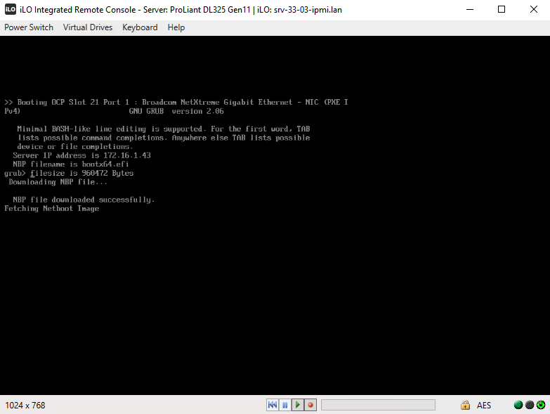

Third boot the machine performs network boot, throws a bunch of messages and retrys a network boot, when this time it stuck on “Fetching Netboot Image” for a few minutes, until it timeouts to “grub>” prompt.

Attached timeouted grub prompt:

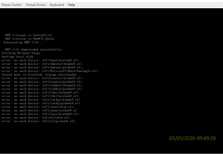

In general if the machine is trying to PXE even if it’s already deployed MAAS should provide a grub config that instructs the machine to boot from the disk. You can try to take a tcpdump to better understand what’s going on (or look at the rack logs)

As far as I understand this (3rd) boot the machine should boot localy ether from “rocky” UEFI entry or from local drive.
And looks like the machine failes to boot from network and instead of booting the local drive retrys the network uefi boot.
Prior the “Fetching Netboot Image” fallowed by timeout I see the following:
Can you manually instruct UEFI to boot from the disk and then you ‘ls /efi/‘? What’s the output?
