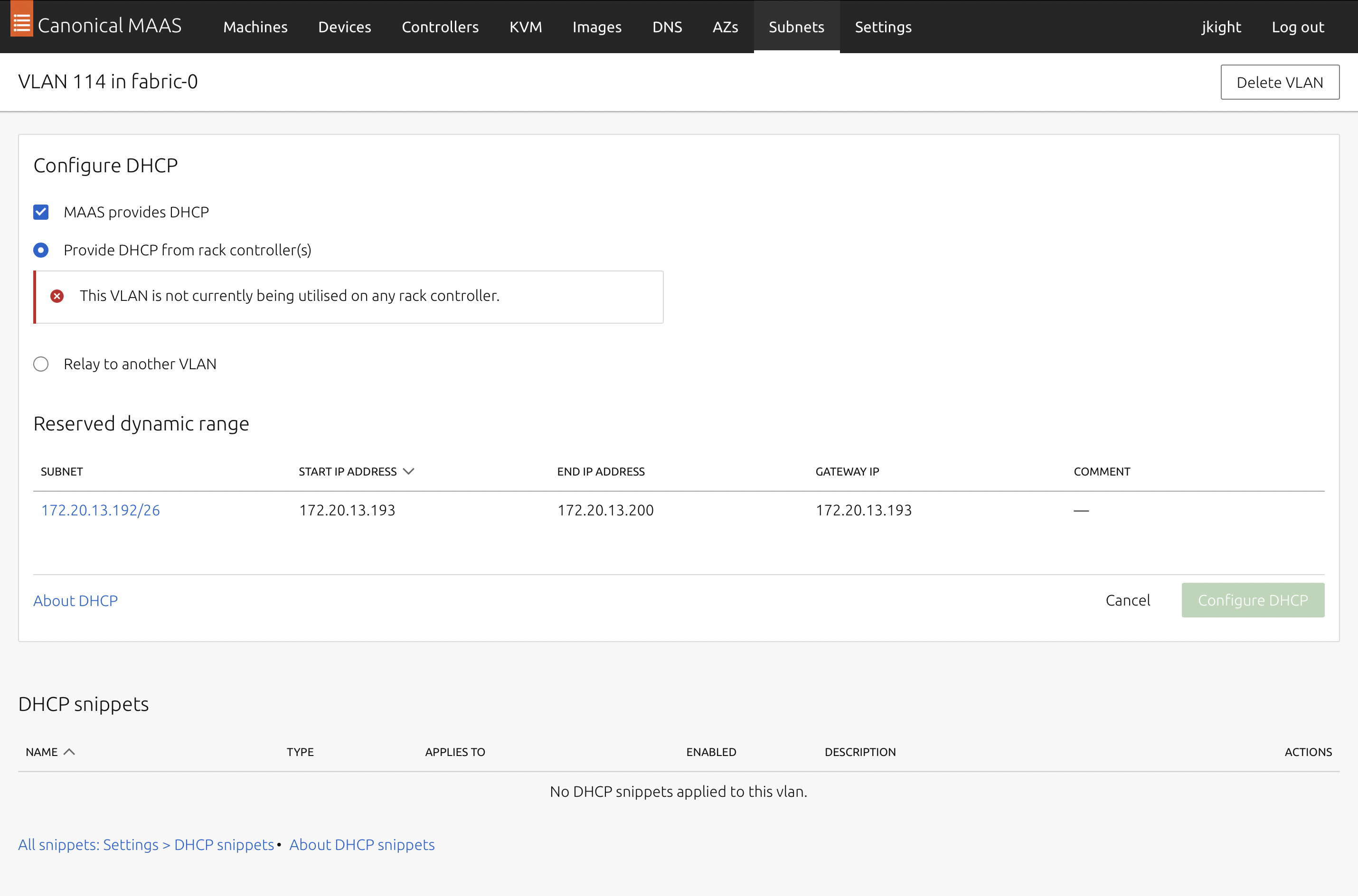

I am unable to select “Provide DHCP from rack controller(s)” with a message in the GUI that:
“This VLAN is not currently being utilised on any rack controller”

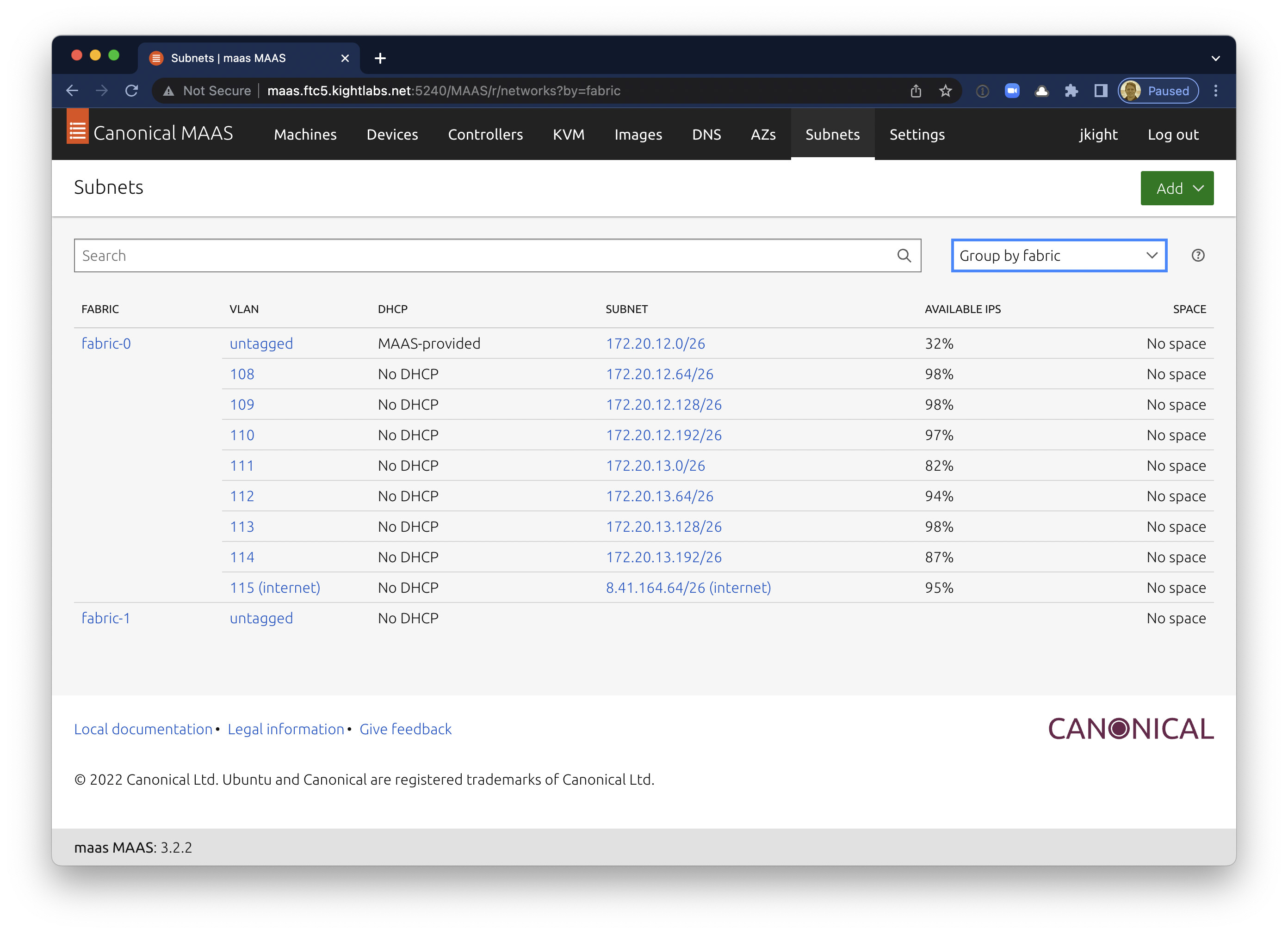

@jeffkight, can you post a screenshot of your subnets tab?

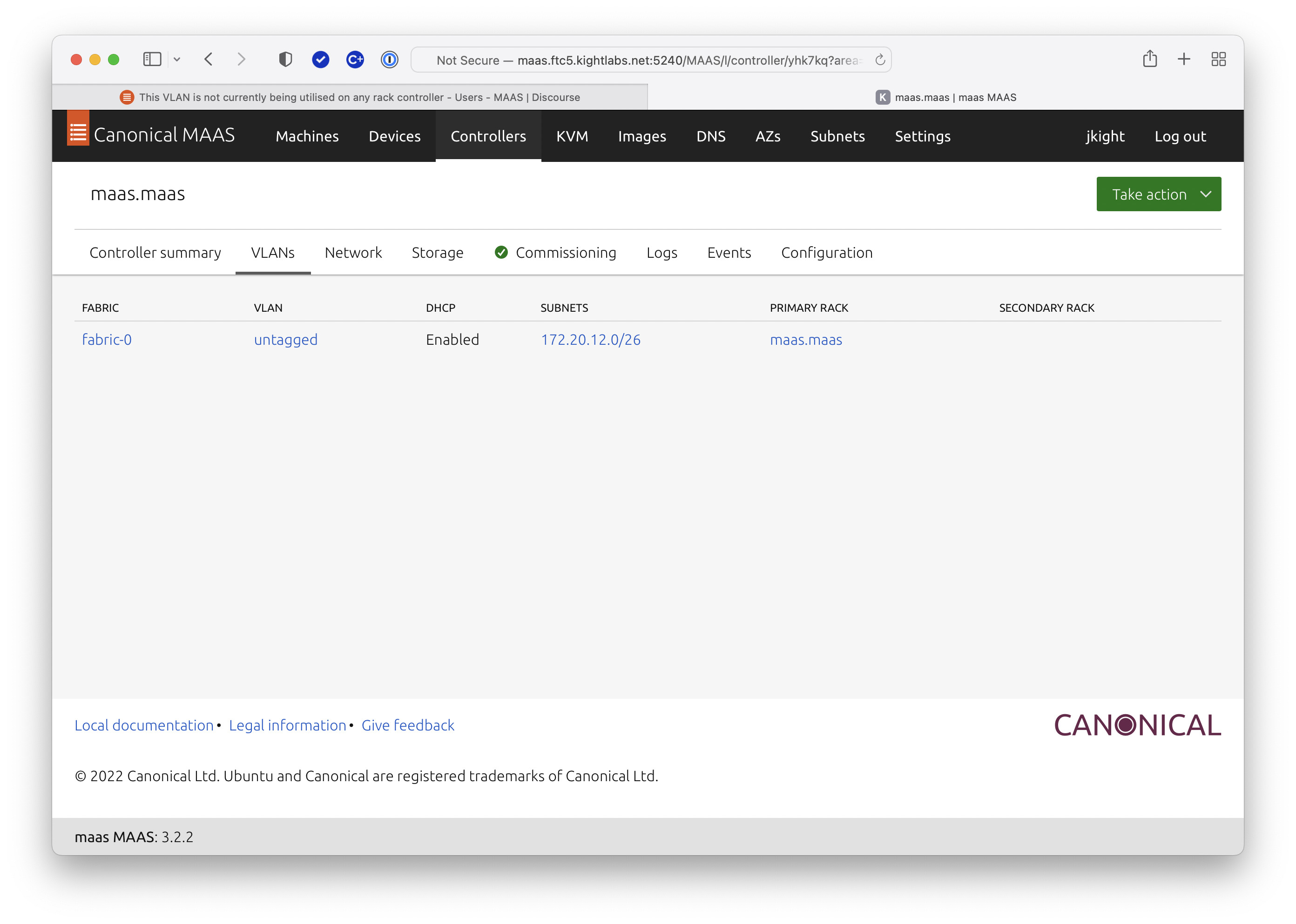

Hmmm… under Controllers -> VLANs I only see the untagged VLAN.

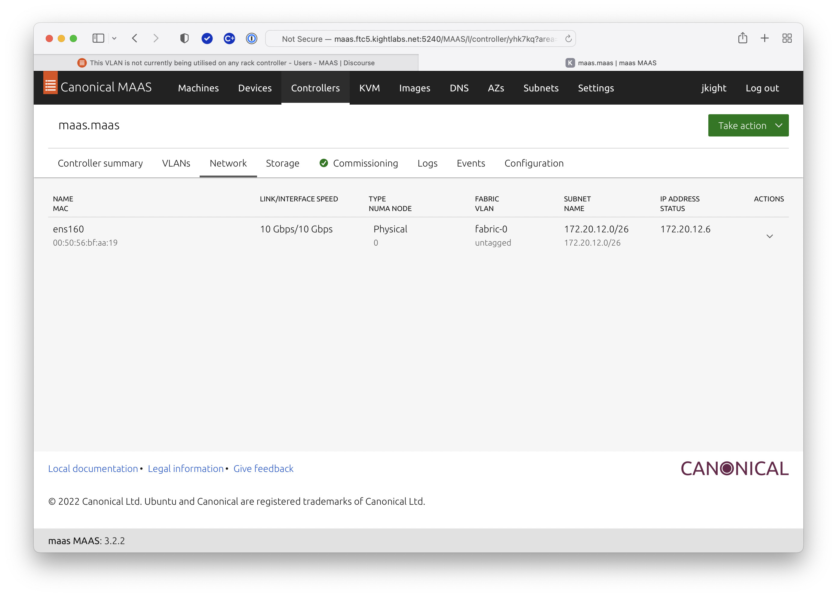

On Controllers -> maas.maas -> Network I only see the untagged network.

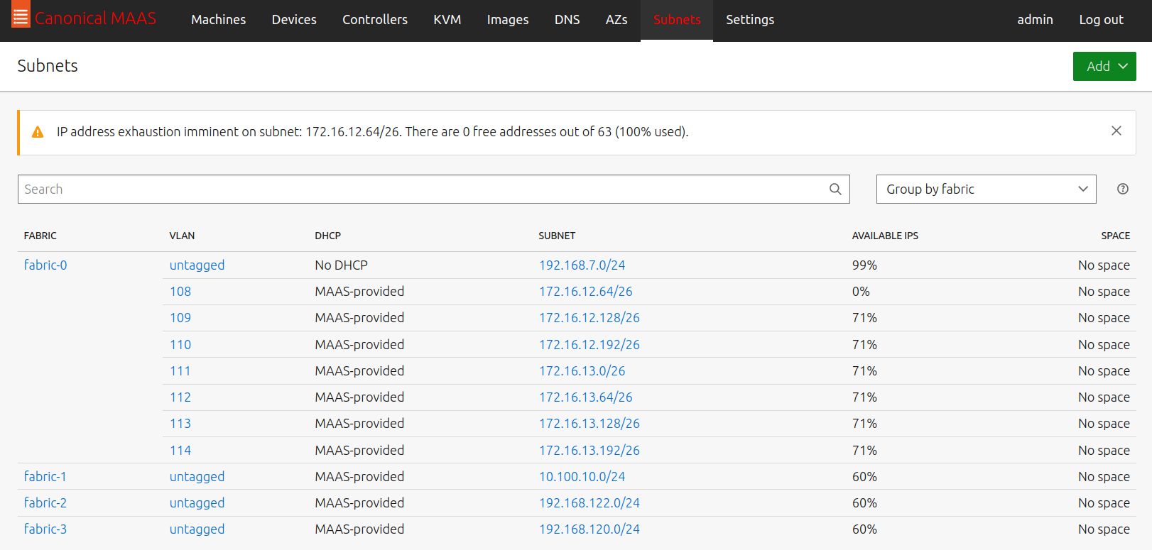

I believe I’ve nailed this one down, after talking to Bill internally. I have a reproducer (a simple VM with MAAS 3.2.2 installed) with your VLANs configured manually in MAAS (Add → VLAN, Add → Subnet for each defined VLAN).
Then on the rack controller itself, I updated my netplan YAML with the following:
vlans:
vlan.108:
link: enp7s0
addresses: [172.16.12.64/26]
vlan.109:
link: enp7s0
addresses: [172.16.12.128/26]
vlan.110:
link: enp7s0
addresses: [172.16.12.192/26]
vlan.111:
link: enp7s0
addresses: [172.16.13.0/26]
vlan.112:
link: enp7s0
addresses: [172.16.13.64/26]
vlan.113:
link: enp7s0
addresses: [172.16.13.128/26]
vlan.114:
link: enp7s0
addresses: [172.16.13.192/26]
Once that was done, netplan apply sets those values. I went back into MAAS, and for each VLAN, enabled DHCP on that rack controller (the dropdown allows me to select the rack controller itself). Saved, and proceeded through the rest of the list.
The end result looks like the following:
